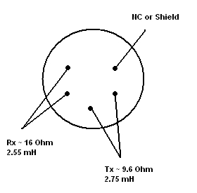

              I measured values again today and got slightly different result for Tx inductance. I attach an image with the pinout. I'm not sure for the last pin if it is free or shield (if coil has shield).
              Regarding Tx power standards, I am not going to comply with them as I'm not going to build a commercial detector. Also my frequency will be below 9 Khz.

                Thanks for the clarification, right now, my larger coil is stored away, as I was not that thrilled with it. My finds dropped off when I used it over the regular 8" coil.
                Also, your image coil, is black plastic, and mine is white plastic. So I was curious whether or not, yours is the exact same coil as mine. It could be, as mine was a Christmas bonus, coming along free with the normal detector package. Perhaps that is why mine is white color...
                I did try it with the Teknetics Mark 1 detector, and it did perform better with it, as the Teknetics Mark 1 has greater power than the Bounty Hunter Pro red machine.
                When I get a chance, I will dig it out, and check the resistance, inductance, and ohms of those pins you designated.
