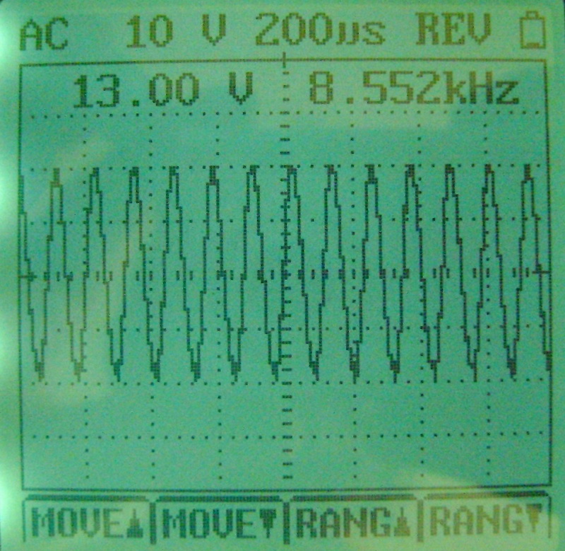

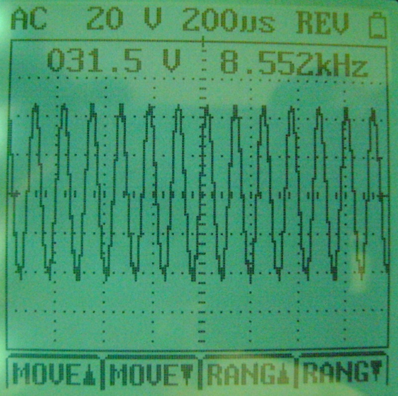

                        No 120v, no turbo 13v with turbo has 31.5v
                          yes, that is more logical, the detector is stable 31V?
