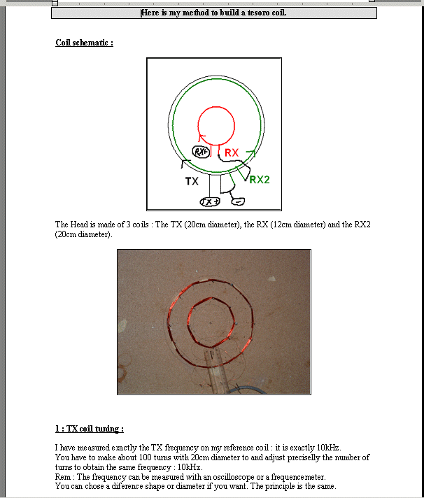

    Hello, Looks Great!! What size wire are you using??? Thank-You Gene L.
      Re: tesoro coil

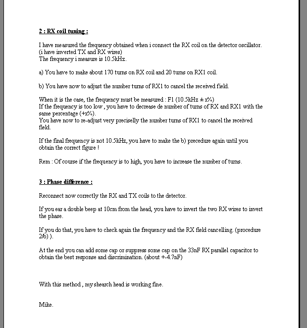

      Here is the following of the doc
        Re: tesoro coil
        it is written in the second part of the doc (i have just added it in the forum)
