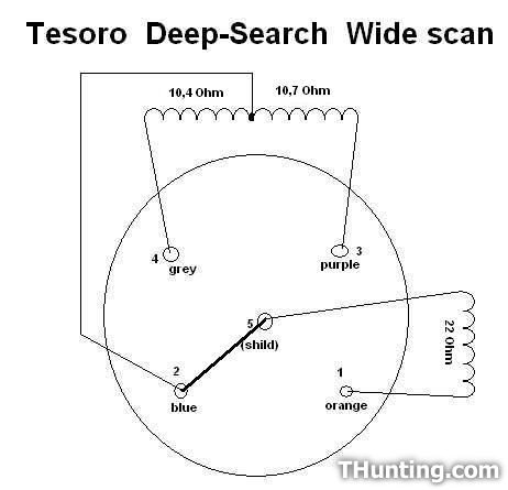

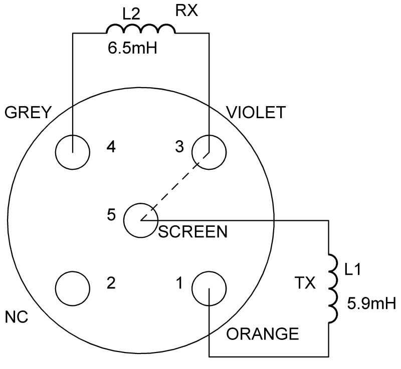

    haveing trouble in the wireing up of my coil i have 2 pictures one says pin 2 is not used the other says it is any help please
    It's the lower picture. The top one has a center-tapped coil, and is from a different detector to the Bandido.

      forgot to say my coil is a 7 1/2 inch widescan and of a laser hawkeye(deleon)
        thankyou
        The Laser Hawkeye coil should work fine with a Bandido.
