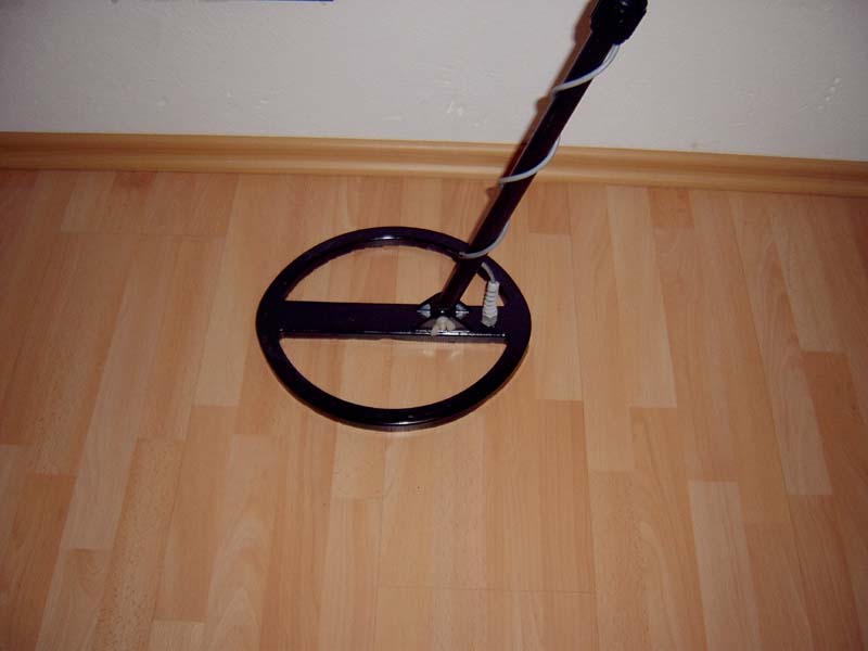

    Hello all,
    I built a DD-Coil for my X5. I shielded it with Graphite and connected the shielding of the coil to the shielding of the wire. So far so good, but I did not yet find out where to connect it to the detector.... That might sound stupid, but If you open the X5 Connector, you will realize that there are only 4 wires connected to the machine ! I measured them, and found out, that these are only the two coils (How surprising). But where is the shielding connected to ? None of the Pins seems to be connected to ground (Minus Pole of the Battery).
    Any Ideas or Suggestions ?
    Best Regards,
    Manuel; DL2MAN

          Re: Troy X5: Where to connect coil shielding ?
          Hello,
          The size of the shell is 29cm x 26cm. I designed it myself, and let the mold be milled.
          I don´t have Winding Details, since I wind and measure until I match the Inductance. Actually I sawed 3 D-Shaped Boards, put them together and used them as coil-winding-aid. The size of that coils are the base of my shell construction.
          I nulled them with my Oszi, by connecting them to the detector, and measuring the RX Coil Signal. Then I moved them until the scope shows a straight line. Then I glued it to the graphite-sprayed shell, and filled it with epoxy resin.
          Best Regards,
          Manuel; DL2MAN
                  Hello again,
                  Pin 1 and 5 are connected, Pin 1 is the shield wire of RX.
                  Pin 4 and the metal threading are connected.
                  Pin 4 is the shield-wire of TX-Coil.
                  When connecting my coil shielding to theb threading, nothing changes. When connecting ist to pin 1/5 it´s getting a lot more quiet. But still not satisfying.... It seems, that I made a mistake at my coil-shielding...
                  Next one will be better....
                  Thank you so far.
                  Manuel ; DL2MAN
                    Your coil looks great!!!! Hope the next one works out the way you want it to!!!!
