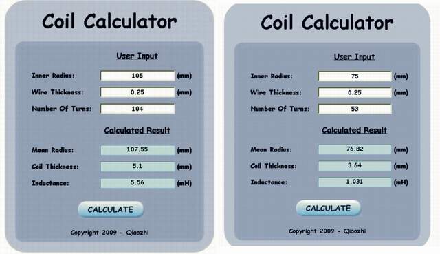

      Inner radius for TX is 21cm and for RX is 15cm!
      Not according to your own calculations. You stated that the TX diameter was 21cm, and the Nulling coil diameter was 15cm. Therefore the TX radius is 105mm and the Nulling coil radius is 75mm. These are the values I used in the coil calculator. You've been working too hard!
      Also, the coil calculation includes the resin thickness.
        Oh man!
        Something is wrong with your calculator!
        I just checked it.
        It calculated 70.5 turns for 6mH on 21cm former, using 0.25mm wire!
        Not right! Not accurate!
        I am sure my coil has 104 turns with wire (0.25 without resin...90% sure) and my brand new inductance meter reads 6.04mH!
        Wires are not constrained tight...but also are not loose at all. It is former taken from scraped GTI coil. It has own cuttings, pretty convinient for wire windings. I actually do not need to constrain wires at all. Those are tight enough.
        So... i think your calculator is not accurate...
        Ignore this post. BS made by ivconic!
          Sheeeeeeeeeeeeshhhhh!
          Radius, RADIUSSS!
          Y E S! You are RIGHT! Sorry!
          Your calculator is ACCURATE!
            Yes...now this makes some sence!

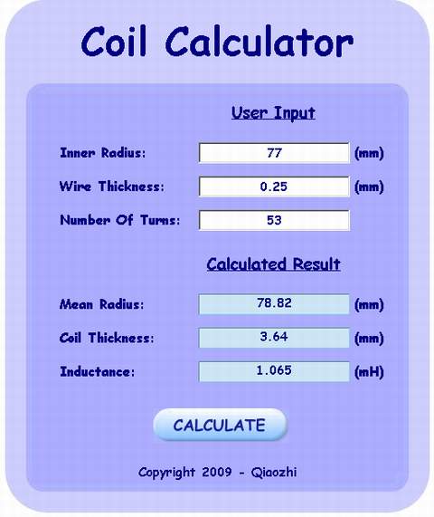

              Ok..one more thing. Minor correction. Inner radius of Cancel coil is a bit larger than 75mm, cose there is RX coil below it...occupying few mm's! Let's adopt inner radius for Cancel coil as 77mm...

                In my calculations I have assumed that you will need to increase the TX inductance by the same value as the nulling coil. In practice this will not be the case, and the increase in turns may be much less than 9 turns. A lot depends on the amount of coupling between the TX and Nulling coils. I would start with 9 turns and gradually remove a turn at a time until the coil is correctly nulled.

                  You are using an early version of the calculator that contained an error in the calculation. The inductance value is always too low. Please use the new version. I've attached it to this post.

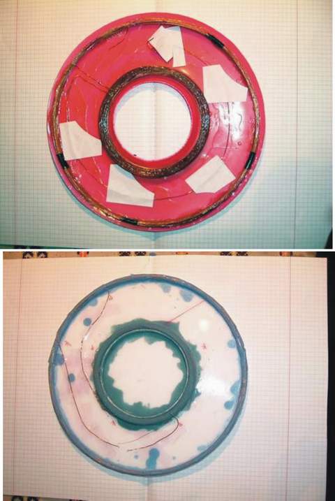

                        So... 2 coils, same axis, same plan, you may say same former holder (one coil is 15cm and another 21cm as on posted photo).
                        Wired in serie, in phase - giving one inductance,
                        Wired in serie, in antiphase - giving another inductance!
