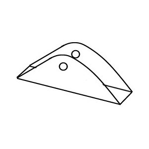

      IF the ears are totally bad, then it might be easier to remove what remains and install a new set. I have found they can be made by bending a piece of ABS into a U shape or use angles and simply glue them in place.
      The glue to be used will be ABS plastic dissolved in MEK. If enough ABS is used, the mixture will be a thick slurry type liquid that makes a great glue. Put this on the pieces to be glued together so there is an ample amount on each and stick the two pieces together and let dry completely. When done, the bonding is more of a weld and is almost as strong as the original material. If you can't find MEK, then acetone can be used.
      If just one ear is bad, then you might try reinforcing it with a piece of the proper plastic bonded to the ear using the slurry mentioned above.
      Now, I have attached a pic of the basic design of the bracket I have used in the past.
      Reg

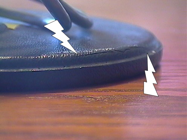

        Here is a pic of the crack....
        As you can see, it's only a crack. It still seems to be a strong as I didn't notice it till I really looked.
        What I have done so far is melt tie-wraps and basically welded the cracks. It looks not too good, but it aint bad either.
        The next step is to get MEK and try to "smooth" it out.
        Thanks for the input.

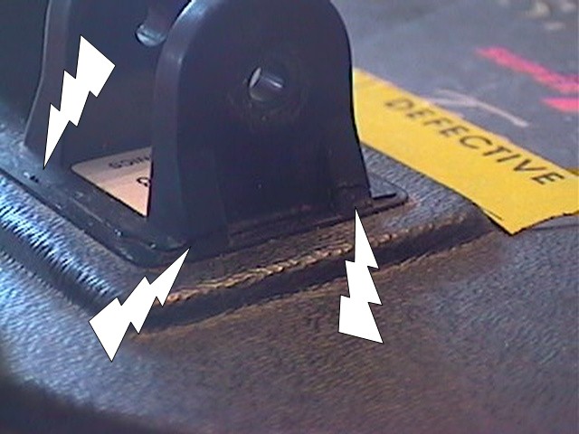

          Another part opf the CRACK

            I loaned a Gold Bug 2 to a friend which he used for quite some time. When I finally felt it was time to get it back, I found out that he has slammed a trunk lid down on the coil, creating a bunch of cracks in the housing.
            As a solution, I simply made up a fair amount of "slurry" made by dissolving diced ABS plastic pieces in the MEK. I took this slurry and simply painted a coat over the surface. In a few cases I had to go back and add a second layer.
            When done, the housing was sealed again.
            Now, when building coils while using one of Bill Hay's coil housings, I will take some of the extra ABS plastic Bill usually sends with the housing and dissolve it in some MEK. This slurry is then sucked up in a plastic syringe and then applied to the crack where the two halves of the housing meet. The crack is effectively sealed this way and the two halves of the housing are firmly attached to each other. The down side of using a syringe is the air pockets that can get in them. This makes it difficult to get a nice even flow.
            If I am in a hurry or can't use a syringe because I am out of them, I will simply dab the slurry on the gap between the two housings using a small paintbrush. With a little care, it works almost as well. This would probably be the method I would use to try to fill the cracks in the housing you have.
            Reg
              Re: Another part opf the CRACK
              Excellent information!
              This was what I was gonna do. I will just make a small batch of melted plastic and dab it in place, then sand it down to look mor "natural".
              I will take pix of the process and post them in another thread.
              Thanks for the help.
