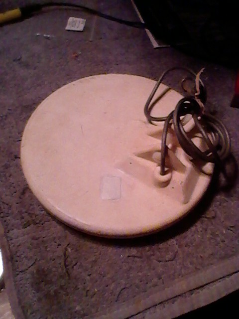

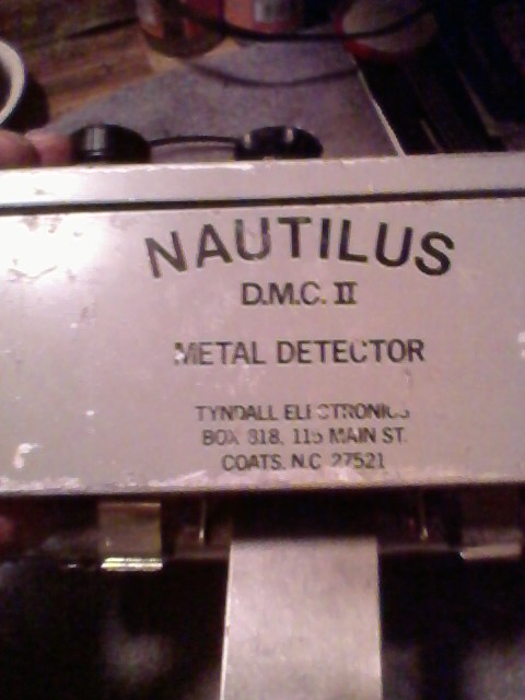

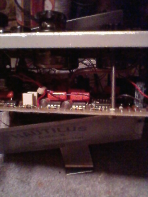

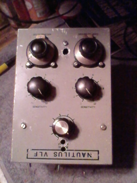

      I have a Decrepit Nautalis DMC II here someone could talk me out of . Click image for larger version
ID:	352437 Click image for larger version
ID:	352438 Click image for larger version
        Poor thing has seen better days.
        The Nautilus coils are balanced in FULL resonance (not "OFF" resonance like the TGSL) and 0 degrees phase shift at null, just in case someone else is curious to know.
        Kindly post photos of PCB if you can.
        I'll put pcb trace of metal detector Aquasound.
