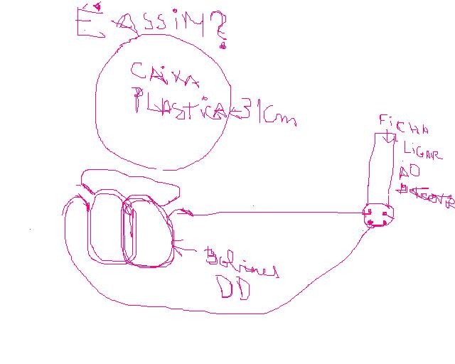

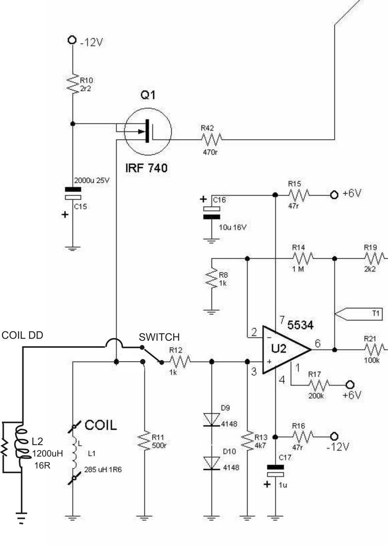

    hello. helped me make: 50x50cm. was perfect, works 100%. now I want to help build ,COIL DD, PULSE-INDUCTION(40x40cm.)
    From: 1200 UH, HOW MANY ROUNDS OF WIRE, TWINE THICKNESS THAT? TWO COPS ARE ON D? CAN SEND ME A DRAWING? THANK,S

    Here are some ball park figures for you.
    SIZE TURNS WIRE SIZE INDUCT RESISTANCE
    Ø 120 mm Round 36 Ø 0.40 mm / 0.14 mm2 405 µH 1.9 Ohm
    Ø 150 mm Round 31 Ø 0.40 mm / 0.14 mm2 394 µH 2.0 Ohm
    Ø 175 mm Round 28 Ø 0.40 mm / 0.14 mm2 387 µH 2.1 Ohm
    Ø 200 mm Round 26 Ø 0.40 mm / 0.14 mm2 406 µH 2.2 Ohm
    Ø 250 mm Round 22 Ø 0.40 mm / 0.14 mm2 380 µH 2.3 Ohm
    Ø 300 mm Round 20 Ø 0.50 mm / 0.20 mm2 390 µH 1.6 Ohm
    Ø 400 mm Round 17 Ø 0.50 mm / 0.20 mm2 396 µH 1.8 Ohm
    Ø 500 mm Round 15 Ø 0.50 mm / 0.20 mm2 400 µH 2.0 Ohm
    1.0 x 1.0 m Square 10 Ø 0.66 mm / 0.34 mm2 406 µH 2.0 Ohm
    1.4 x 1.4 m Square 8 Ø 0.66 mm / 0.34 mm2 387 µH 2.2 Ohm
    1.8 x 1.8 m Square 7 Ø 0.80 mm / 0.50 mm2 398 µH 1.7 Ohm

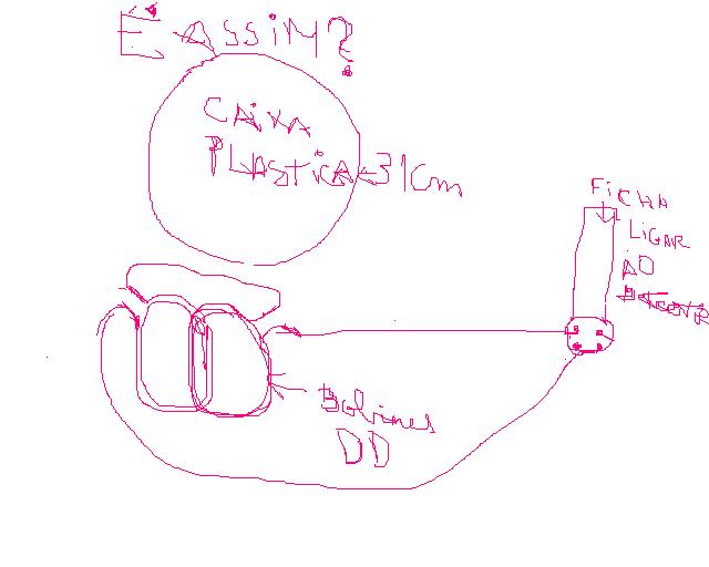

      hello to everyone. after I explained to pi, DD, for the same circuit, but to diameter of 30 cm plastic housing. how to connect the terminals of the 2-reel? how many turns of wire in a CADF? the thickness of wire can be in: 0.60 mm? this design is correct osecution? then how it should be? a hug.
