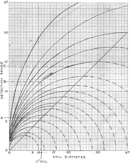

                Hi Geo,
                I have attached a chart posted several years ago by Eric Foster showing what one might expect for depth when using different coil sizes. It takes some time to figure out, but I have found it to be reasonably accurate.
                Unfortunately, ground conditions can distort the final results, especially if working areas where the ground is bad.
                Now, with that said, the general concept is if you are getting less but close to half of the diameter in depth, then increasing the coil size will not help that much.
                As an example, lets say you are using the 12" factory coil on the TDI and only can detect the coins at 7", then making a larger coil may only gain 1" to 2" max and that doesn't take into account if you have trash in the area that can affect the results.
