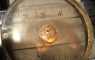

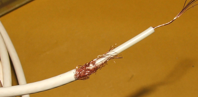

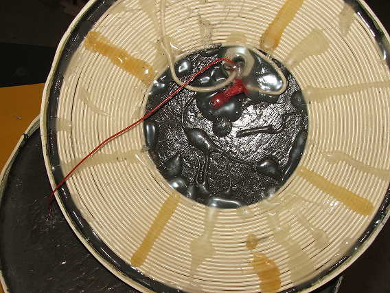

    Just for fun I made a coil from a old coax cable ( ca. 15 meter), striped it from the shielding and outside PVC, so only used the inside wire with its tick isolation. Look at the photo’s, not the most beautiful coil…, I made it with some hot glue and a old 24 cm coil form .
    For testing I connected it on a Surfmaster-PI… the results for small gold are very good ! The small very thin gold medal can be detected ! ….. Other tested coils ignored it !
    So if you have some old coax…

      Hi Appie. Very good info! I think can be used monofilar coax here. Maybe you obtain good results because the spiral form.

        Umm are you saying the PI wouldn't detect the gold medal with the standard coil?
          Hello Bklein,

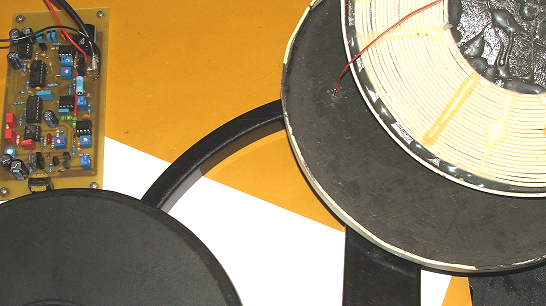

          Well……it was my intension to show how a simple good working coil can be made. The photo’s give some more info how to make the coil, no secrets al very easy. And yes…. the other coils they did not detected that very thin gold medal…. Keep in mind that this gold medal is very.. very thin ! Also some VLF detectors do not detect it !
          (photo shows the detector with 3 coils)

            What do you recommend for the coax - or does it matter much? Stranded isn't too common in my garage....

            Did you wind the coil for the coilform or intentionally wind it for some specific inductance (how best optimize the coil design for a variety of coax choices).. Sorry for so many questions - I don't have any hands-on time with coil making yet. It is my next move when I get some play time.

            Your example here looks simple enough but I don't think the coax I have is stranded. Need to do some shopping.

                ApBerg,
                When you have the coil windings very close together, like when using magnet wire, you get more inductance, but also quite a bit of inter wire capacitance. the capacitance increases the Flyback decay time.
                Thicker wire also increases capacitance.
                As you increase the space between the wire turns, the capacitance decreases, making the coil faster.
                some time back, I posted pictures of coil building with thick magnet wire. To reduce the capacitance I used a Polypropylene string wrapped around the magnet wire.
                Air is the best insulator.
                Polypropylene is a very good insulator.
                The polypropylene string as a spacer between the coil windings uses air and PP and produced a very fast coil.
                I don't remember the title of my post, it was something like "coil with polypropylene spacer".
                Here, I managed to find the thread. http://www.geotech1.com/forums/showp...98&postcount=1
                Note the sampling time of 2.5uS. very good for gold nuggets.

                  Ap,
                  What is the self resonance of the coil in the housing with the shield connected? This should be measured at the connector end of the wire only.
                  This one measurement tells you much about the coil wire-to-wire capacitance, shield-to-coil capacitance and coax capacitance.
                  Your use of the thick insulation and the spiral wind of the coil with 23 turns should produce a very low capacitance coil. The coax cable capacitance is based on the dielectric constant of the insulation and the thickness of the insulation. Use the shortest coax that is convenient. Typically, the coax cable only needs to be about 32" to 34 long to reach the coil. Normal coax cables are about 27pf per foot and a low capacitance cable would be about 16pf per foot.
                  Coils with the highest self resonant frequency have lower capacitance and require less damping in the form of a higher value damping resistor which makes a more sensitive PI detector for smaller targets when operating at lower delays.
                  If the coil operated at the lowest delay, do some research on your schematic to find a way to reduce the delay a little more by about about 2us to 3us to make your PI machine more sensitive to smaller objects. Making a faster coil only provides the potential to detect smaller objects if your PI circuit can use that potential. typically only a resistor change can reduce the delay. See Carl's Hammerhead Article and look at the modification section and find the same delay resistor in your PI machine.
                  Make sure that you take advantage of your fast coil design by optimizing the value of the damping resistor. Increase the damping resistor value in 100 ohm increments and look at the output of the first amplifier stage with an oscilloscope to see that the pulse damps a fast a possible with no ringing. My guess is that you could try a damping resistor about 200 ohms higher in value. This is one part value that must be fine tuned on the coil, and coax used to make the coil to ensure that it is optimum for that coil.
                  If you change coils, you can make the damping reistor on the circuit board a little higher than optimum discussed above by about 100 to 200 ohms for a underdamping situation, then use a higher value (2000 to 5000 ohms) in the plug to fine tune each coil to be optimal. This way you can change coils and all will be optimally adjusted to your PI machine.
                  Nice Job!

                    Thinkerer : In the past I have seen some ‘hollow’ coax. Do you think this is better than the one I used?

                        You can try the hollow kind of coax or the foam kind, but probably there will not be much difference.
                        The spiral wound coil has very good sensitivity at the very center, but it's detecting field gets very narrow some distance from the coil. Like a funnel shape.
                        This means that you have great sensitivity at a good depth, but only about the diameter of the center hole in the coil.
                        You can also wind a bundle coil with the same cable. The capacitance will be about the same, because of the shielding. The spiral coil has more shielding surface, that adds some capacitance.

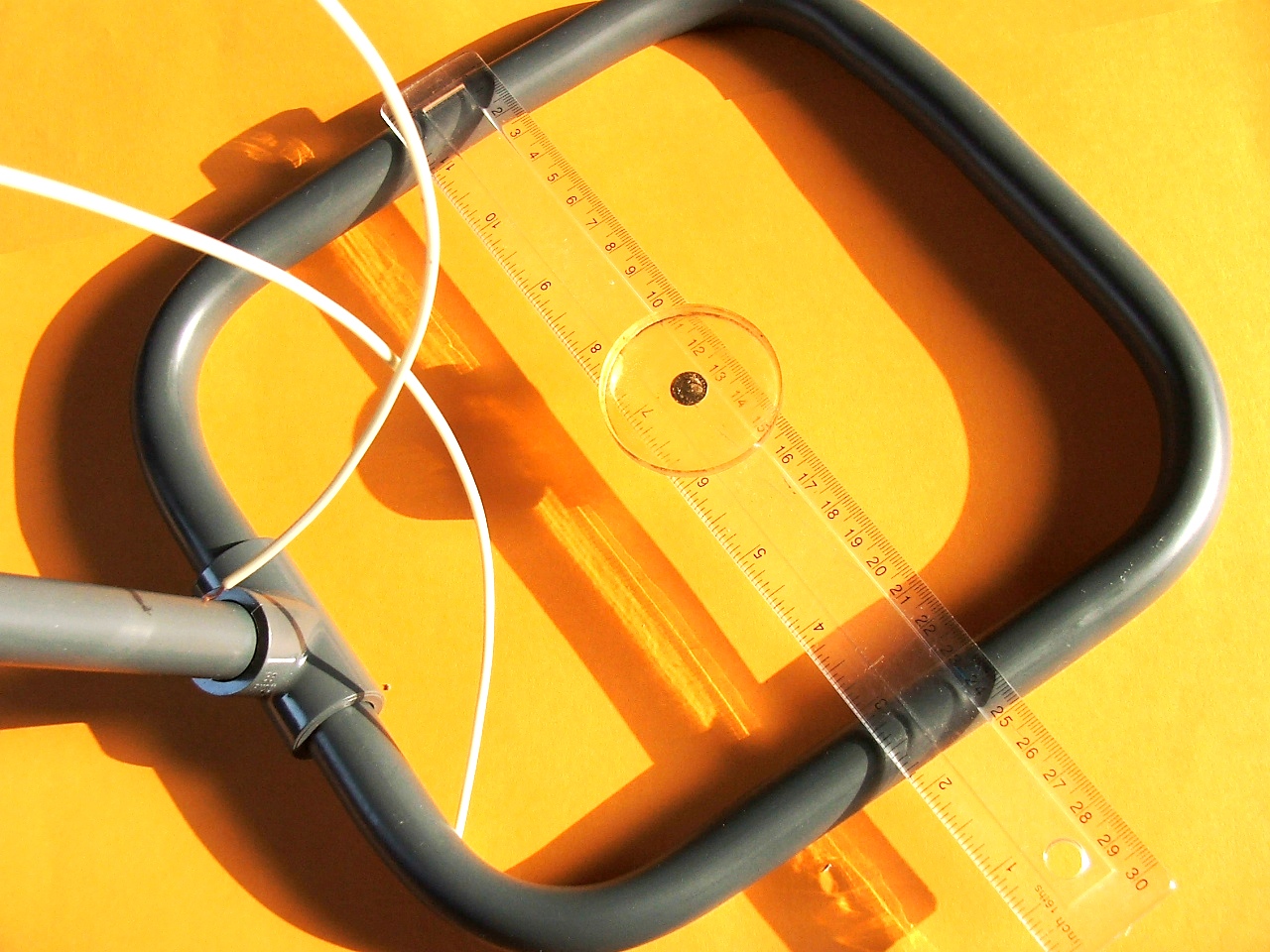

                            Hello Tinkerer,
                            The spiral coil detects over the whole coil, not only in the mid-opening
                            (small medal for ca 80 % )
                            A cola can is detected at almost 1 meter and gives even a good response when it’s at the side from the coil.
                            To see the effect from the coax cable I made also a square coil ca. 25 cm, ..... It has the cable bundled in the tube (what a work this was)
                            .....It did not detected the small gold medal .....
                            So it seems that the spiral coil is in favor for detecting small gold.

                              3 coax coils
                              Hello Friends,
                              Hi ApBerg I wonder how to connect 3 coils to an recieve transmit on pi detector.Please help Regards Gosta.
