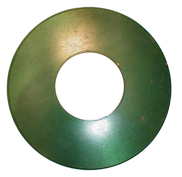

Here is a pic of the Tesoro Sandshark PCB spiral coil:

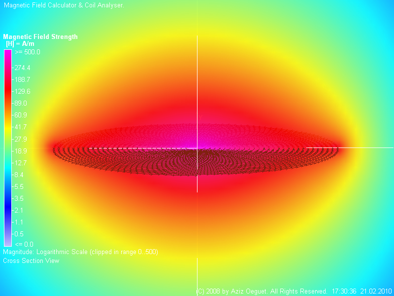

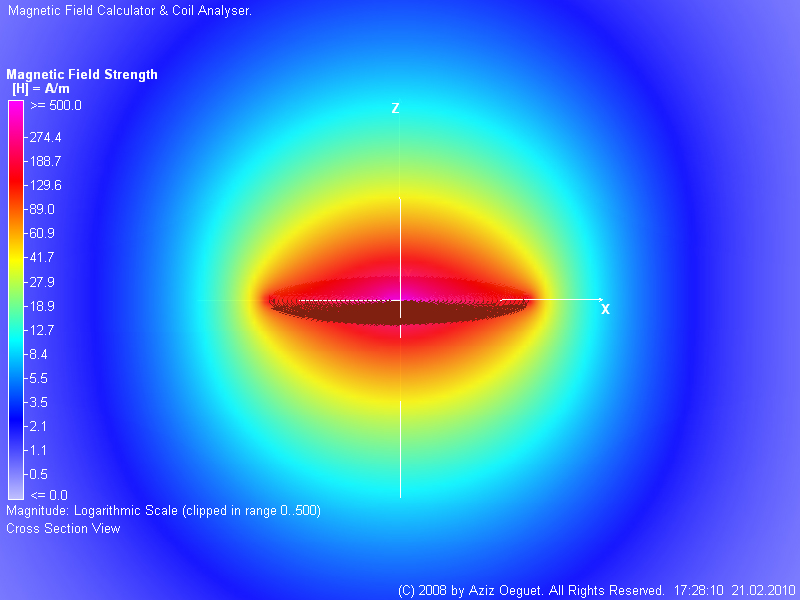

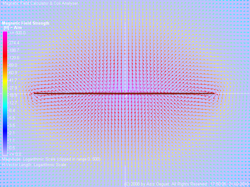

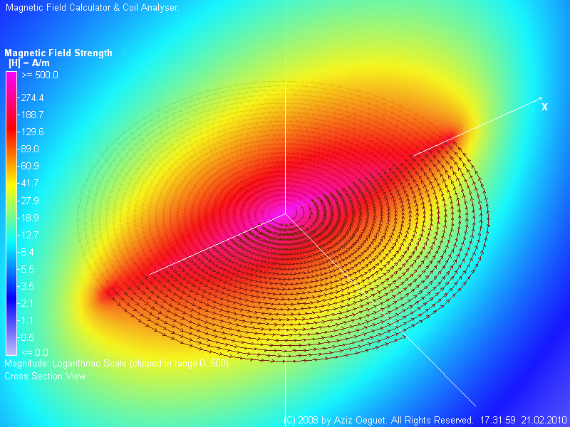

Experiments with spiral coils
Want to see the magnetic field strength?
Coil:
10 mm inner diameter
195 mm outer diameter
28 turns
Coil current: 1 A
Aziz
PS: The zip-file contains all images.

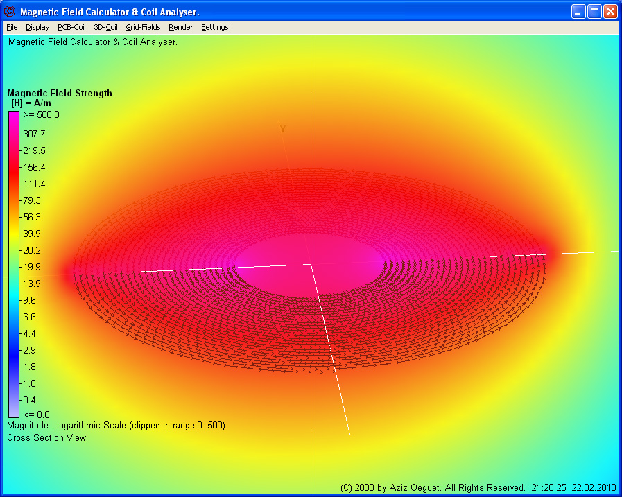

This is something, what Carl posted look like:
Inner diameter: 60 mm
Outer diamter 195 mm
28 turns
AzizAttached Files
I think what Carl posted is standart Tesoro coil housing
Inner = +/- 85mm
Outer = +/- 195mm
And 42 windings.
