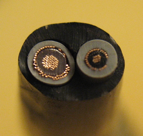

    Does anyone have a source for the Minelab FBS Coil Dual Coax Cable from the control box to the coil? Look like they are two different size coax wires in the same cable.

      Here is a cross section of the cable.

          Here is another try at the picture.
            Definitely custom.
              Ok. If no one has a sorce for this, what are you using from the Explorer control head to the coil in it's place when making coils for the Explorer series?

                Not sure I've heard of anyone making homemade Explorer loops, but you can try S-video cable. It's twin coax.

                  The cable is made in NSW Aust and they will not sell it direct been there tried that, use two separate coax cables as I do when making DD coils I use low capacitance audio cable branded "Soundlink USA High Grade Audio Interconnect OFC Cable" I hope this helps.
