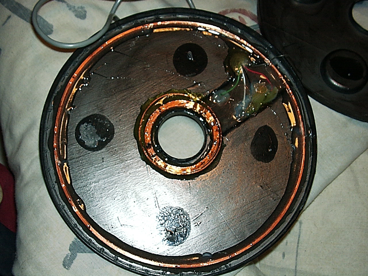

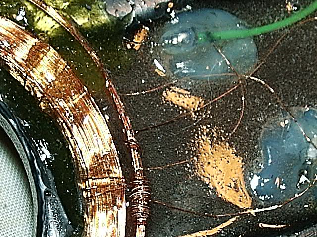

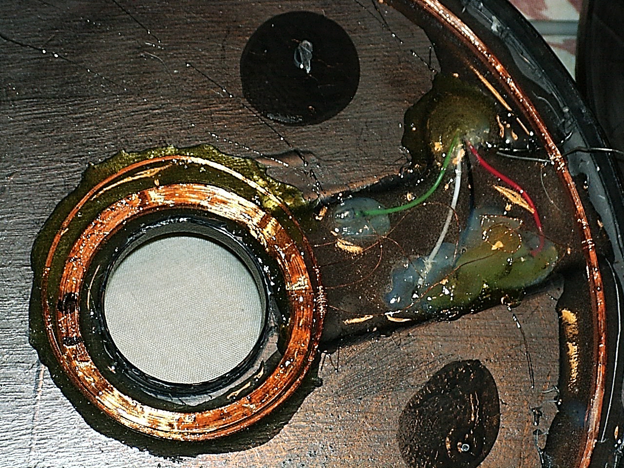

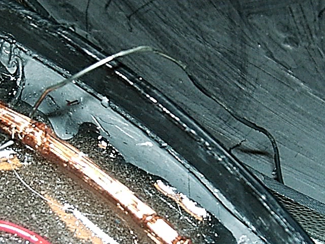

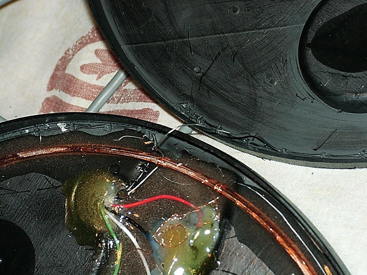

                        Redheat coil stripped down pics
                        Hi out of the two redheat coils i have this one is not performing as should be its about 2 " off depth compared to the other coil and it wont discrim a small nail even on full discrim,so i thought id open her up so you can see whats goin on inside,enjoy lads
                          Originally posted by dejavuband View Post
                          coil works fine double bleeps when targets are close to coil,discrim works fine too, but the coil lacks depth as it will only give 6" on victorian penny,can you remember the wire colors in the 5 pin tesoros ?the ones on the redheat are green,red,white,black+an outer strand also that connects to the black,im really convinced that the 5 pin tesoros will work better on the redheat any suggestions?
                          This was the coil that i had checked on induction meter,red,black,outer wire pins 1,2 5.6MH and white,green pin numbers 3,4,5.4MH,can you see any probs at a glance?
                            So, you have another coil of the same make and model?
                            Maybe you could compare the inductances and resistances of the two coils?
                            A lower reading on the coil with inferior performance would indicate a shorted winding.
                            edit:
                            I know that sounds obvious, but I did not read where you had done that comparison.
                              edit:
                              The coil in these pics is a 9" redheat polo and the other coil is a redheat 8.5 2D wide-scan,would the values differ from coil to coil if diff sizes or would they differ on each individual coil anyway,sorry im new to all this,i did a continuity test and the bare wire thats pinned to the black goes to the shield,the other coil 8.5 is far superior to the polo,ill get the other induction reading on the 2D coil then to see where we stand,cheers
