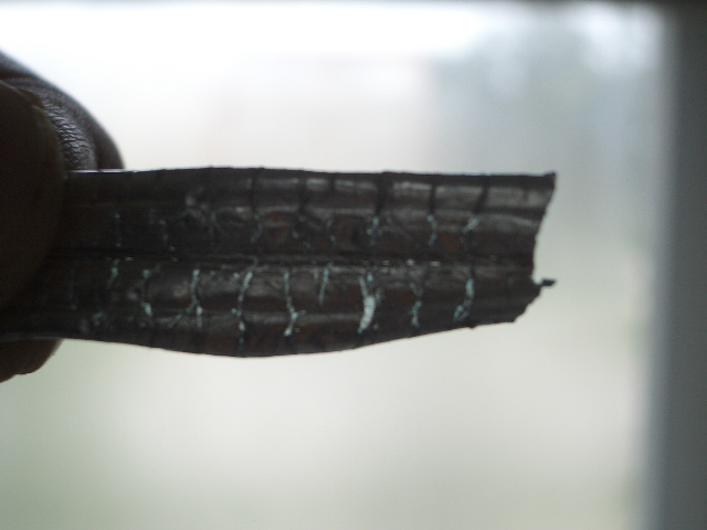

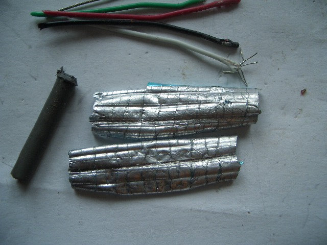

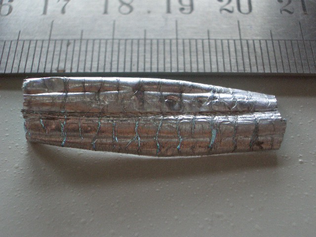

                          that I see in this coil cable with the problem... a shield is broken maybe on all his length... these parts of the shield have not electrical connection together.
                          this fact must give you a some mind in case you wish buy an oldie coil...

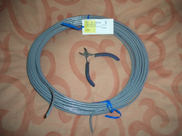

                            cable has arrived. 30 meters of length.

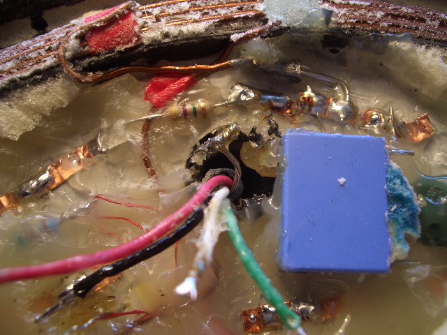

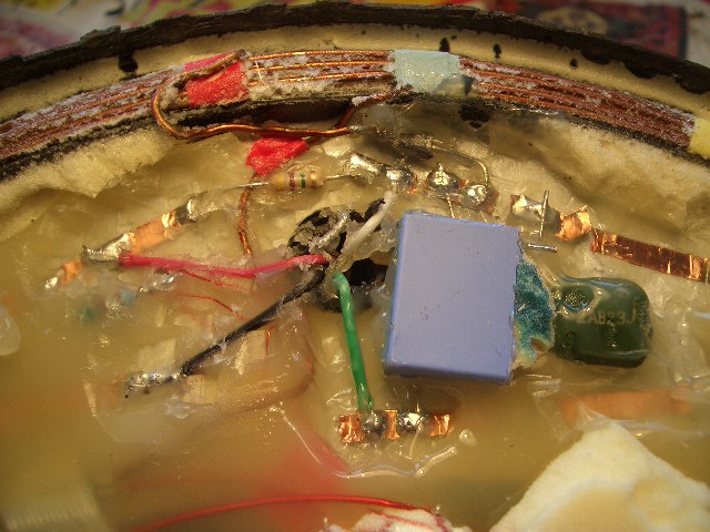

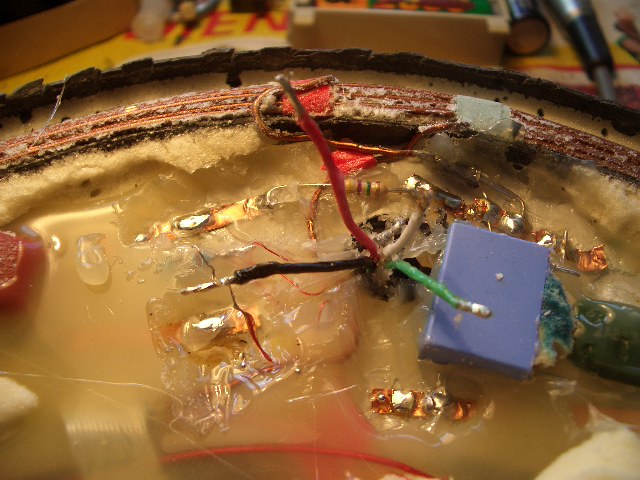

                              inside of the coil
