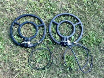

Hi a bit of success for home built dual field coils.built by an for the hobbiest an enthusiast.
Suit the Pulsemate PI detector an others,Minelabs Pi,in the sd/gp/gpx series etc.
wired to 5pin specs to suit minelabs Pi.
12inch outer coil,an a 6 inch inner for sensitivity on small targets.combined.
with screening for brush an knock resistance in the field from falsing.an EMI.
overall low ohms in the range of 0.9ohms total.
Silver plated multi strand/teflon wire used for these.
ElectroDag screening on internals etc.
Works very well!on many PI.
regards Rov
