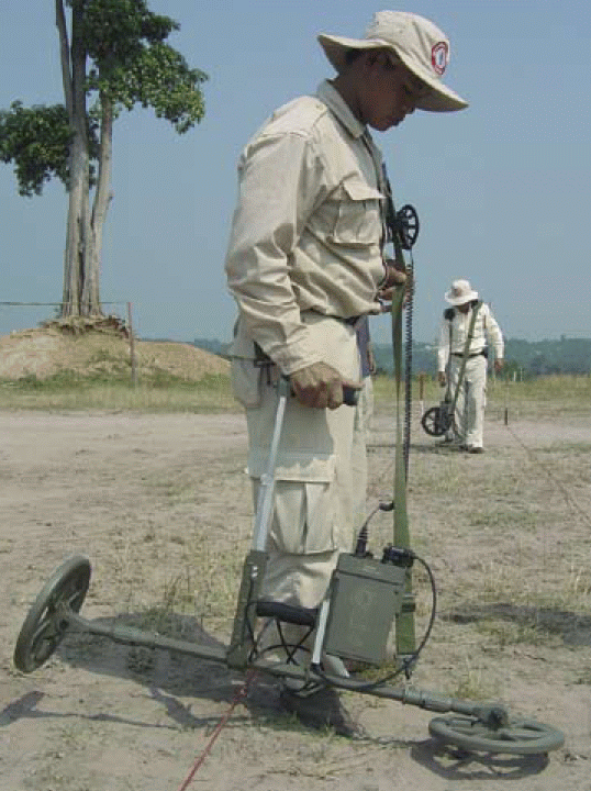

        The correct name of TWO BOX loop configuration is "Almost Orthogonal" or shortly "orthogonal". The picture shows in use mine detectors model MIL D1/DS designed in Italian company CEIA. When both "boxes" are adjusted in induction balance, they are not exactly orthogonal. Each "box" has overall diameter 280 mm.
        The (R)EMI group experimented as search oscillator for BFO metal detector an almost orthogonal loop configuration with larger TX coil (overall diameter 520 mm) and two 250 mm RX coils connected as TWIN LOOP. The experiment shows that the configuration can be adjusted in wideband induction balance (2kHz - 20kHz) if the TX coil is made of Litz wire. That means the configuration is suitable and for PI metal detector.

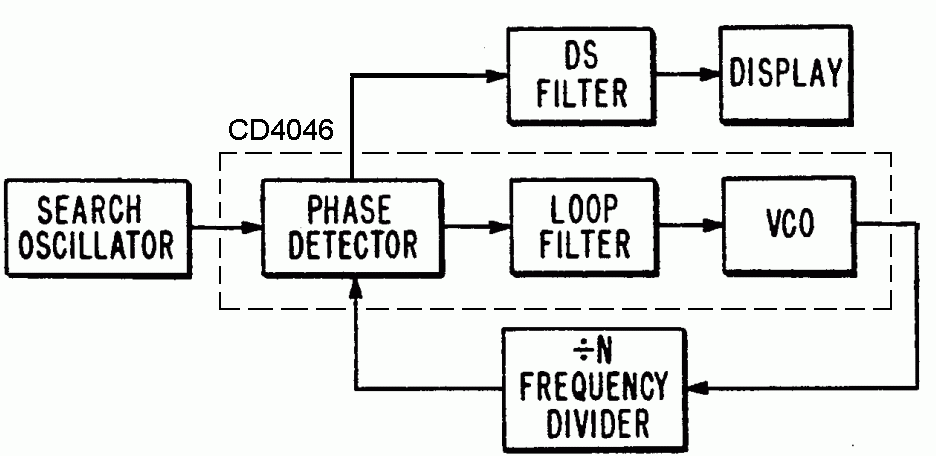

                Hi mikebg,
                can you post block diagram about this here? Thanks!
                  Hi mikebg,
                  Hi WM6,
                  The title should be "2 box coil on a BFO detector", but more correct is "Orthogonal loop configuration in search oscillator".
