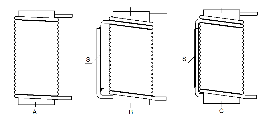

        1. Reinvented is an old method for descreasing resonance frequency of a conventional solenoidal coil.
        In the prior art, Nikola Tesla uses flat spiral coil wound bifilar, where both windings are connected in series to decrease the resonance frequency (see posting #1). In the reinvention, a solenoidal coil is used because it is wound easy and can be achieved more inductance at given volume (see position A in the attached figure). The reinvented priciple is shown as position B in the attached figure. Note that there is a soldered region (position S) where leads of windings are connected by solder. The principle can be improved because the S region can be used for addional decreasing of resonance frequency if it is placed to lay direct over turns as shown in position C.
        2. Reinvented is the unleaded (environment-friendly) solder wire. The lead-free solders are preferable in EU according European recomendations for health and environmental protection. This last is no joke because the solders are more expensive and have more high melting point.
          Thanks, Mike.
          So the segment of wire that crosses the coil (flat or solenoid) alters the resonance frequency of the second coil?

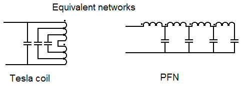

            Stefan,
            The attached equivalent circuit diagram shows that there are a lot of stray capacitances. They form a lot of resonance frequencies. This fact is used in electronics for delay of wideband analog signals and forming of powerful pulses. If you wish to learn more, search WEB for:
            "delay line"
            "Blumlein transmission line"
            "artifical transmission line"
            "synthetic transmission line"
            "pulse forming network" or PFN.

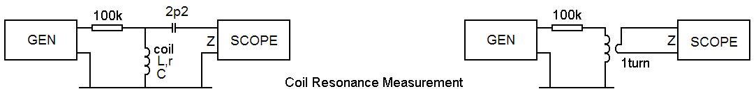

                      Hi Gary,
                      Stray capacitance between scope leads and input impedance of scope form an impedance Z as shown in attached circuits.
                      In the left test circuit, the impedance is increased by adding a small capacitor.
                      In the right test circuit is used a wire connected between scope leads to form one or two turns. Tesla coil has resonance.

                        Never Tried that.
                        But in the second circuit that Resonance may just be a result of your one turn coil.
                        I only use a 1pF cap and I have also used the X10 input, with no resonance showing.
                        But I Can't believe that a 1 pF into the 1 meg input impedance will form a Low impedance to not show a resonance.
                        And It DOESN'T on a normal coil of any kind, so why would it on a Tesla coil?.
                        Also going into the High scope Input is a 9.5 Meg Input.
