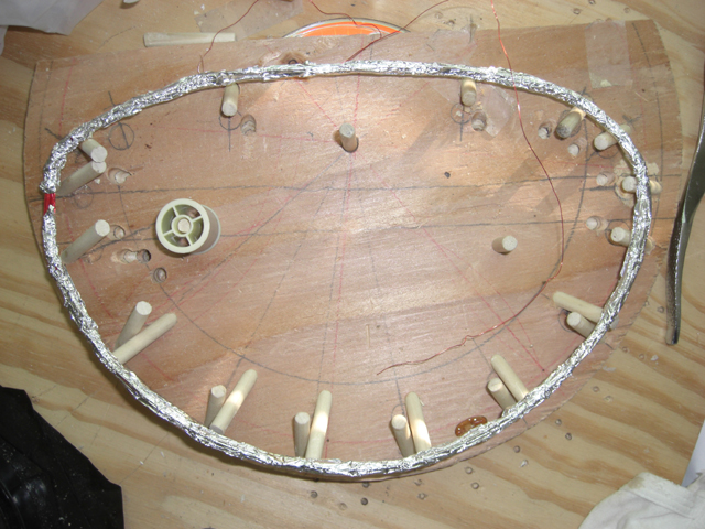

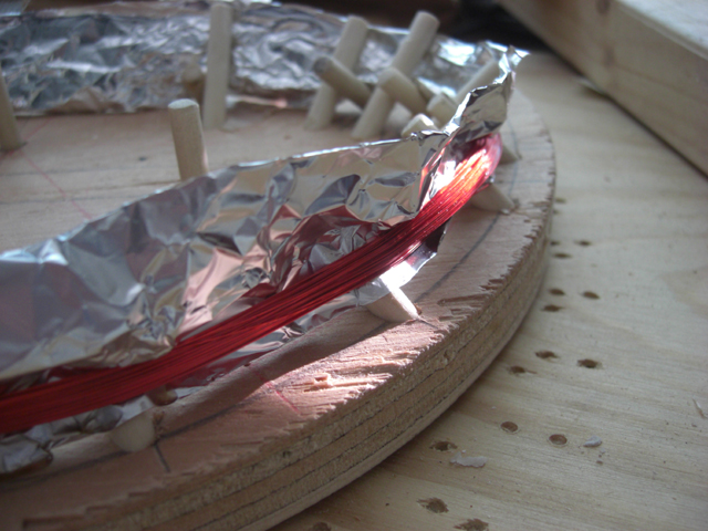

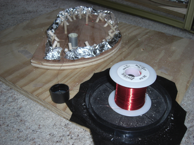

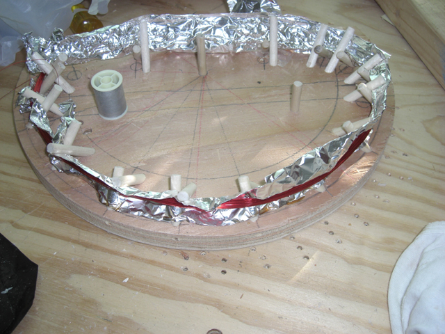

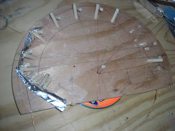

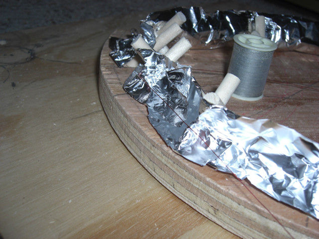

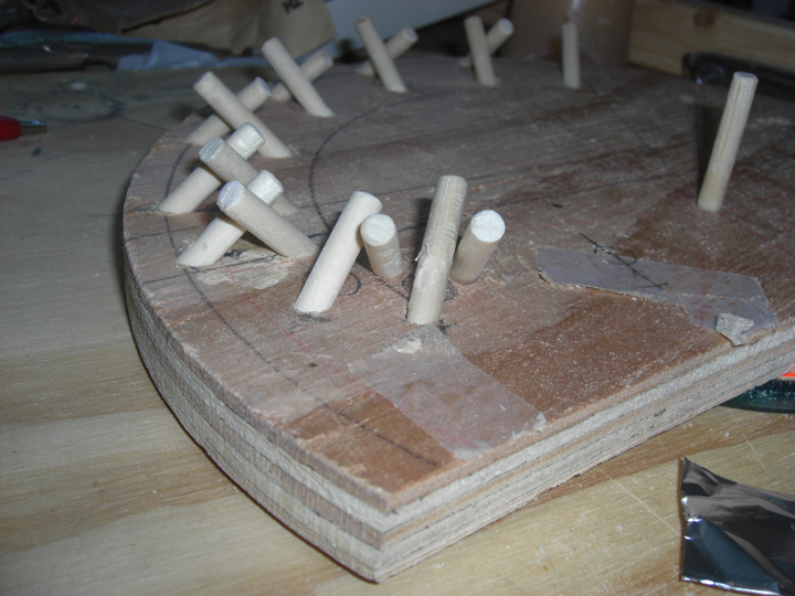

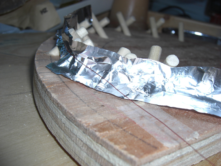

Variation on coil winder with "stockade pegs", set at crossing angles.
Idea is to create a channel for wire to compress coil. Hopefully, put foil into channel first (will it tear? do I care?), use dfbowers varnish bath to coat wires, then when dry, remove and wrap foil for shield.
Actual plastic channel material probably better... but haven't found any yet.
I made this very sloppy, by eyeball, my drill press too small to do proper job, but better craftsmen maybe make it work???
-SB
