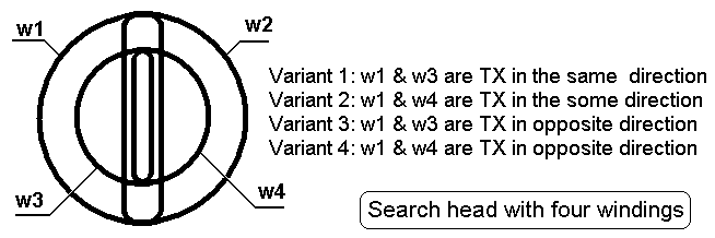

    Cyclops, the nulling is not problem if TX coil is wound of Litz wire, but the hand made is not easy. A try to simplify coil make leads to 4 winding in search head. However arise 4 variants for loop configurations. Which variant is the best?

        Cyclops, I have to ask you to clarify your post. You ask, "will it make sense", but I must ask, how is it possible?
        By "flat", do you mean no overlap in the Z dimension (no step in height)?
        You could wind two D sections of a coil, and you could even make them from flat spirals of wire, but then to make the DD configuration you must superimpose part of one coil over the other.
        So, how would you propose to make everything flat? I don't really see mikebg's reply as a solution because his coils also have overlapping sections that would have to be stepped.
        Would you be intending to sandwich the individual coil turns where the overlap must occur - is that what you mean by flat? (What a nightmare!)
          What detector machine do you plan to use this hypothetical coil on?
          All parameter for Inductance,Capacitance an Resistance are change-able an vary from one machine to the next ,brand an model variation an their internal Electronics for TX an Rx.An Optimised coil construct to suit all machines is a Dream!All you may achieve is a slightly improved Generic Coil if All parameters for best performance are known for all popular detectors to use it on.And we Dont know this? an the Goal posts for Specs. are changing as new Models become available on the market.
          regards Rov
            ...I don't really see mikebg's reply as a solution because his coils also have overlapping sections that would have to be stepped.
            After reconsideration I have to admit that mikebg's entry could indeed be called flat. Flat, and yet having more Ds than Duncan has Doughnuts. My mind can scarcely handle the paradox.

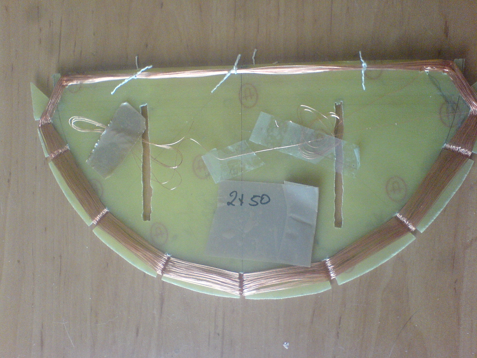

              from theory to practice, I did a hald last night
              quick and dirty
              here is what I project
              picture tells more than words (porcluvr´s too )
              (right, mikebg´s isn´t a solution)
                So this is 2 DD Flat coils?what is the results,seem confusing,maybe I am missing something.
