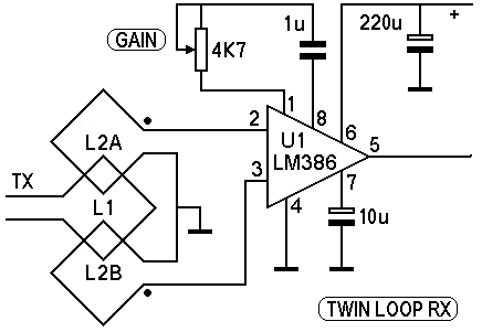

    To avoid shielding in electronics is used circuit symmetry. For example we can make the RX winding with center tap and connect it to ground, but more easy is to use full differential front end or a single preamp with input symmetry. Look how simple is the circuit of front end in a TWIN LOOP metal detector when we use amplifier with input symmetry, for example LM386.

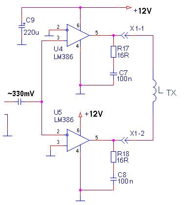

        Symmetry in TX power amp
        And here is a symmetrical circuit diagram of transmitter that uses the same type of IC as in preamp - LM386.

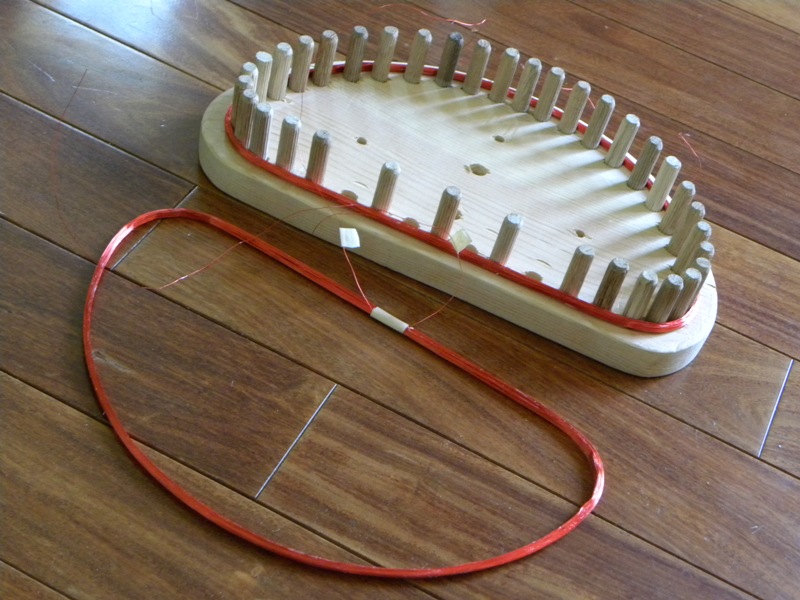

            I'm posting a few pictures of what I've achieved thus far. I will have more as time permits. The coils shown were wound with 30gauge enameled, 25.4 cm. One coil is 100 turns, 6.0 mhH and 19.3 ohms. The other coil is 110 turns, 6.2 mH and 19.6 ohms.
            Each individual coil takes approximately 30 minutes to produce not counting cure time.

                    Hey, that looks good! Do you have a pic of your forms? Do you put the wire on "sticky" or apply glue after you wind?
                      As I said previous you and simonbaker were the inspiration for for trying to find a way to produce a quantity of repeatable and compact coils.
                      I put the wire on "sticky". I tried using varnish but had the same problem simonbaker ( http://www.geotech1.com/forums/showthread.php?t=16828 ).
                      After some experimenting I found a way to use 30 minute or 2 hour epoxy (length of cure time depending on how long I need to wind coil). With 30 minute epoxy I have 5 minutes to wind and then coil is ready in 30 minutes.
                      Will try to get pictures as time permits.

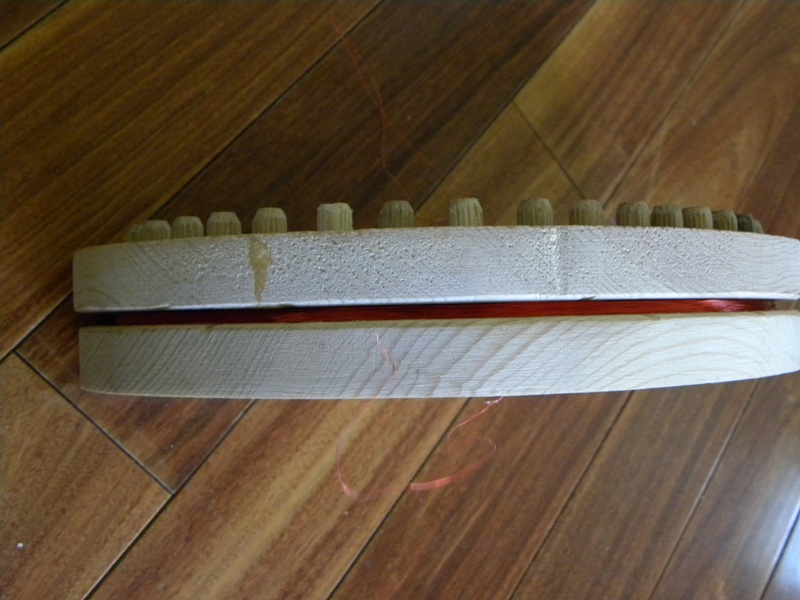

                        Pictures of my coil winder.
                        This is my "epoxy coater".
                        The amount of epoxy deposited is determined by the size of the exit orifice. For the .012 diameter magnet wire that I've been using I've settled on a .018 inch orifice which gives me the amount of epoxy I need to produce a good coil. It's quite easy to use either five minutes or 30 minute epoxy in this form of a two-part syringe. Depending upon wire size I can get 3-4 coils from one syringe. A syringe cost approximately 3 dollars USA. If I'm winding a single coil I will use five minute epoxy. If I'm winding to coils I'll use 30 minute epoxy.
                        Setup is fairly easy takes about 10 minutes. And once you are done winding there's nothing else to do other than let the epoxy cure. You end up with very consistent, very solid and very repeatable coils.
                        The forms are made from three-quarter inch plywood. They are faced with .100 Plexiglas. I have tried different release agents and find that Teflon spray works fine. The real secret is the Plexiglas facing that has been glued to the plywood forms.
                        Using this setup I can make at least six different coil configurations. 2 DD, 2 concentric and 2 Mono.

                              To Monks: Good construction for coil winder, thanks for idea.
