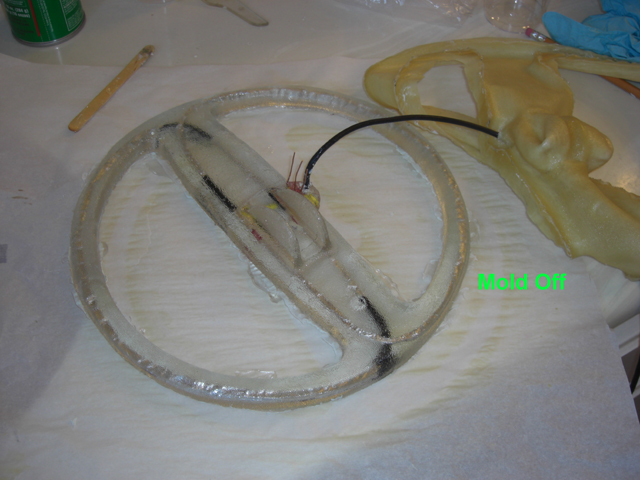

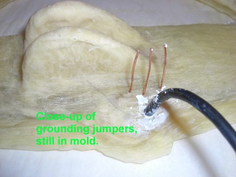

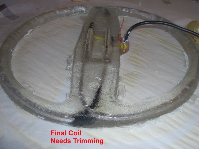

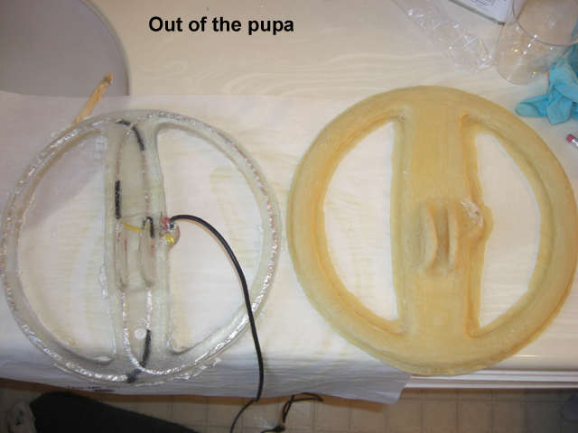

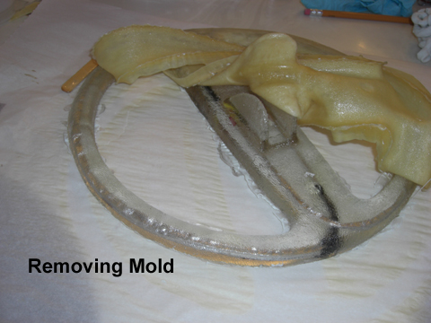

finally good winding
    pics continued
    pics continued...
    Final texture is reproduction of dfbowers textured plastic shell.
      pics continued...

            Hi Don:
            Thanks for the A! I need it. (Or was that for pain in the A...)
            My mold was cast from your (dfbowers) shell (exterior), but I probably poured a little deeper by building up the edges with clay. Also, my mold sagged and probably made everything a little wider. I tried to prop it with clay to prevent that. I think I poured at least 8 oz of resin into it.
            Your coil weighs about 425 grams, mine about 475 grams. Some stuff still needs to be trimmed off mine. I could probably lighten it by drilling or carving to around 425 to 450 grams, but not worth the trouble at this time.
            The resin is quite hard, almost brittle. Depending on how much hardener you use, surfaces exposed to air can end up slightly tacky. Acrylic spray is recommended to finish off with.
            Your vacuum-formed shells are the way to go if you can do it of course. Many advantages:
            1. Looks nice
            2. You don't need to prepare mold.
            3. Don't need several pourings of liquid.
            4. Don't need to hassle with removal from mold, especially cable.
            5. Don't need to worry about coils getting too near edge of mold.
            6. Shell is lighter material.
            7. Shell is probably more durable/pliable material, especially for pole attachment.
            8. More choice of potting material.
            9. More ability to put in micro balloons as Tinkerer suggested.
            10. Easier to support and position cable and coils.
            I think the resin mold-only idea still has merit for hobbiests who don't care about looks and if done a little differently. I'd skip the latex mold and just fashion a mold out of clay on wax paper, put a little resin in, then the coils, then more resin. The pole flanges are the hard part, haven't figured that out yet.

                        It is a little heavier than the coil dfbowers made, but not too bad. About 12% heavier. 475 grams.
                        Because I didn't get the inductances quite right, I'll need to tune it with capacitor C6 I think. So I don't expect as good air distance with dfbowers PCB compared to his coil.
                        I will need to take it to the mountains to test air distance. The noise in my house makes it impossible to get more than 10 to 15 cm with any MD.
                        I think maybe putting the shield so tight to the coil makes it difficult to null - I get a very large null signal. However, I do not yet believe that is necessarily a problem as long as the null signal is due to capacitive coupling.
                        I was not patient enough to get everything perfect this time. But at least I made a finished coil. If I can clean the silicone off it I'll paint it.
                        I did find the pole "flanges" came out a little closer together than dfbowers coil, so I had to put a thinner washer on his pole to make it fit. But it will attach. Next time I would add a support spacer on my mold.
                        It was not too bad to drill holes in the resin. Sort of like drilling plexiglass.
