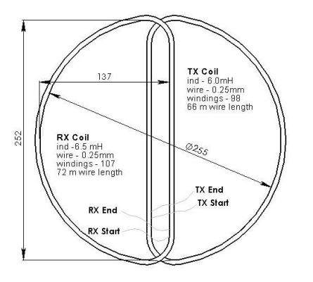

    Hello,
    I have a small problem.
    Somebody can tell me how much wire use to wind D coil for eldorado, and amount of windings?
    I Think About 27cm diamenter.
    Tx = 5,5mH or 6,0mH
    Rx = 6,5mH
    I use 0,28mm coil winding wire.
    And two part epoxy glue
    Aluminium tape for shield.
    Dimensions, size etc. in attachment.
    Cheers,
    Sadowski, Poland
    eldorado coils
    about 140 turns both coils the same
      With 140 turns of 0,28mm wire will be some about 7mH...
      Tx must be 5,5-6mH this is with 0,28mm ~110Turns
      Rx = 6,5mH will be ~129 turns.
      Today or tommorow I will do 4-5 coils ( 3x Tx and 2x Rx) Poliester Resin will be good as a glue for coils?
      I have about 1kg of that Resin.
