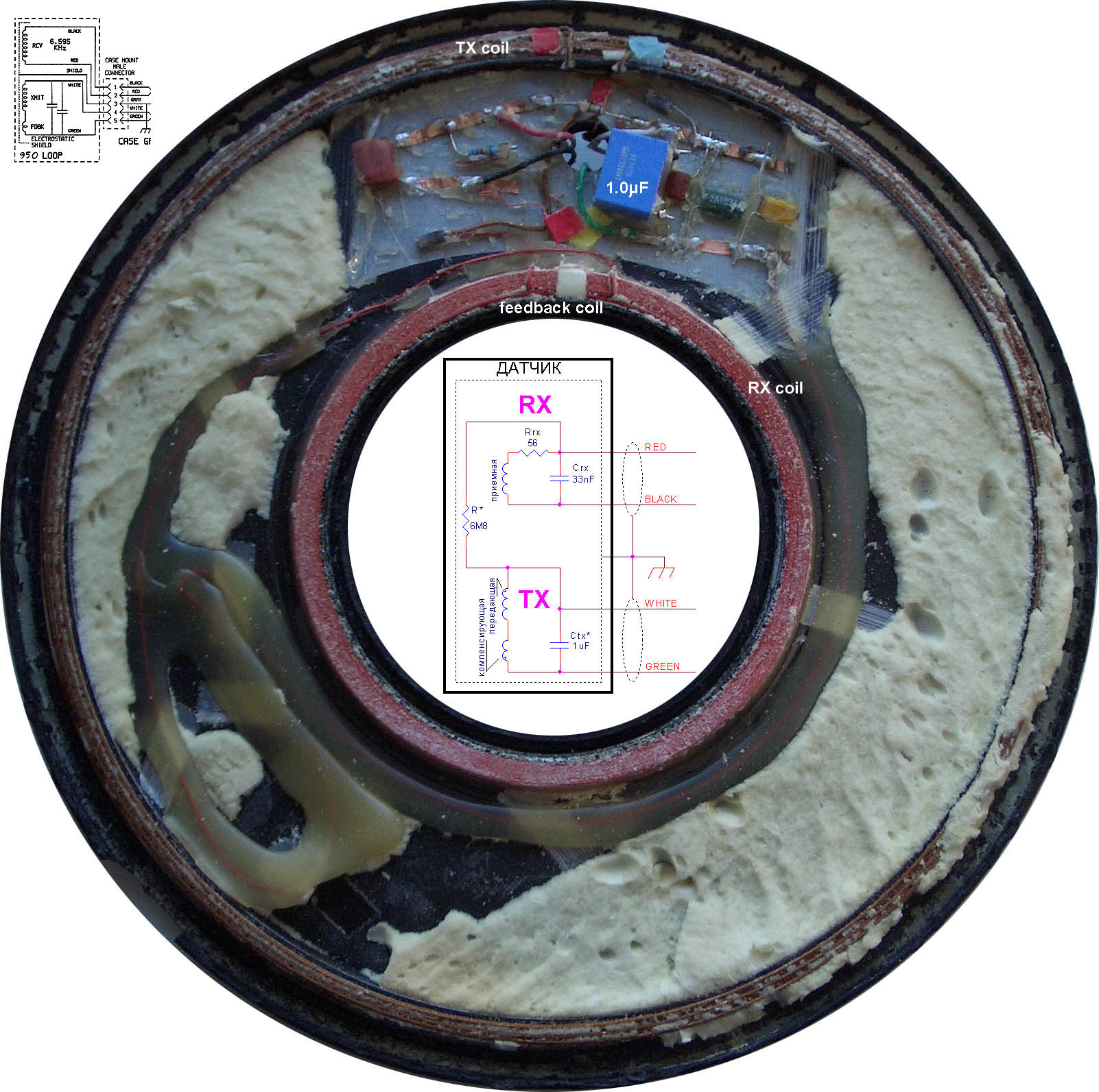

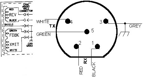

    Hi would anyone have a plug wiring diagram for a whites eagle spectrum stock 9.5 coil 6.59kHz female plug thanks

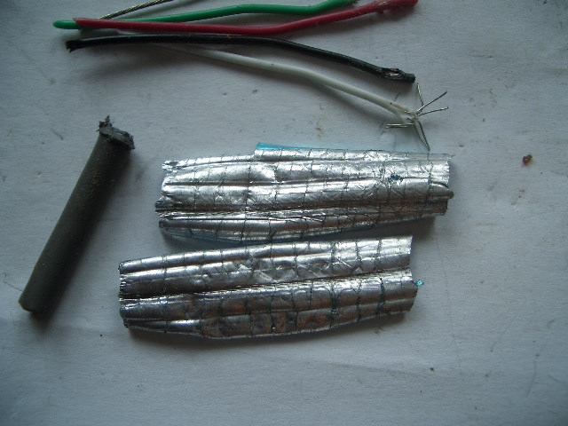

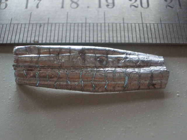

      Thanks for the info the coil wont ground balance but the plug looks like it has been repaired before so ill check that but probaly its the sheilding and no one in australia will repair it but thanks for your time
        I can change the cable. write me if you will be ready to really repair the coil. I am living in Lithuania.
        Yours
          Hi mk02,if your in Australia as you say,try thru Goldsearch Australia in Victoria,Dunolly.
          Tony Mills is the Whites,agent,dealer,he may be able to organise a repair for your coil?
          If not drop me a PM for details an I can arrange a repair elsewhere here in Oz.

            hi kt315, of which metaldetector model is this bobin?
            antonio
              antonio
              hi Antonio, it is clearly White's Spectrum 9'5 coil that they use with XLT.
              good luck
                thanks KT315

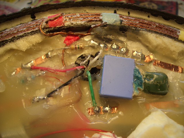

                I just did the same repair, buy an eagle.
                The coil wire was the same.
                Using this information encouraged me to do, and everything went perfectly .

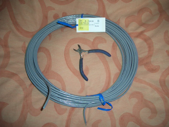

                  Can anyone tell me, how i can open a Bluemax Deepscan 9" Coil, without breaking it?
                  My shielding looks exacly like the kt315's cable.
                  Just orderned 3m new Belden 8723, but i dont know what will be the best method to attach the new wire to the coil...
