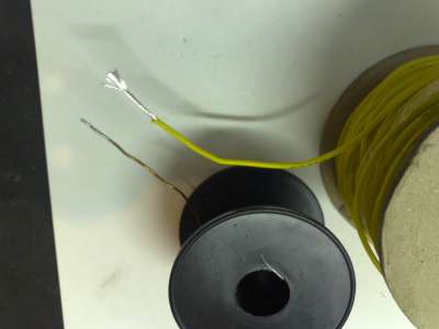

    Besides expense, any pros or cons vs stranded silver plated copper wire of the same AWG?

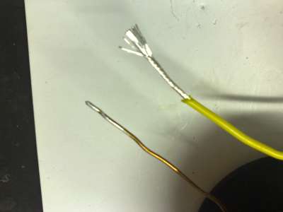

    Hi,what about multistranded solid silver teflon coated,or single strand solid enamel coated aluminium wire?
    Ive tried both for interesting result.very fast coils,and exceptional lower ohms resistance.many PI wont handle these .because of faster timings required.

      I wouldn't hesitate to try "teflon coated multi-strand solid silver wire", but not sure about "teflon coated single strand solid silver wire". Any help would be appreciated. I have the chance to get some but don't want to purchase sonething I can't use or that won't perform better than "teflon coated multi-strand silver plated copper wire".
      I forgot to mention the coils are for a TDI. I'm ready to build a couple more and in the market to purchase wire.

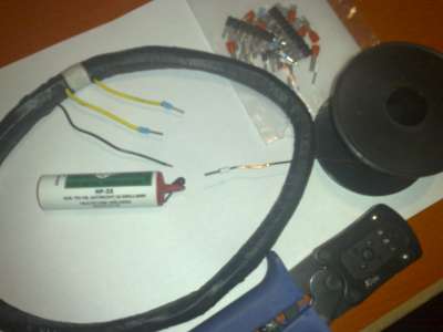

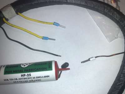

              Hi Tinkerer,for connecting the aluminium wires etc. I use electrical Ferrules,as per used in wiring up switchboards and contactor for plc etc.these just crimp on.then you have an easy solderable solution to your coil lead cable
              also MultiCore UK do specialty solders suitable for even aluminium and other metals.an not overly expensive.

                Thanks Rov for the response, but this topic quickly took a left turn and no answer to my question was forthcoming. I did a little "rough" research and found that solid or stranded solid silver wire is effective at audio frequencies. Since my TDI runs from as low as 10us, the pulse frequency would be 100khz. Therefore skin effect will have to be taken into consideration. So solid silver most likely would not be an improvment over silver coated copper wire.

                On another note, I would not use crimp terminals on aluminum wire. Aluminum cold flows and is suseptable to galvanic corrosion when touching a dissimilar metal. If you do crimp, soldering should be considered. Over time the connection will loosen. This was a problem experienced with aluminum in home wiring. The connections would loosen over time and heat up causing a fire. I don't think any coils are going to burst into flame, but you may experience problems with performance in the long run.

                  But Alu wire can be soldered: you only need very hot soldering iron (say 150W or even more) sand paper and (acidic) solder paste. End of wire have to be thoroughly sanded and immediately moistened with a paste (before oxidize again). We need plentiful of soldering paste at the ends of wire and enough of solder on hot soldering iron for the rapid completion of work before Alu oksidize again.
                    Your right WM6, I worded it wrong (If you do crimp, soldering should be considered). I was thinking of soldering the crimp but then why use a crimp...doh! but yes soldering is needed. As Rov said, there are exotic solders that overcome the difficulty of soldering Al, Certaium being one brand I know of.
                      Hi just thinking on crimps again?the aluminium wires mentioned have use in microwave ovens,and observing the manufacture of connecting this wire type to other wire and components Not aluminium,they are all crimped.So my train of thought had been if commercial applications find it suitable to crimp,then this must be to a electical standard for assembly,is all.Yes I appreciate a galvanic action can take place between disimilar metals.but for a few experimental coils ive built,never an issue.
