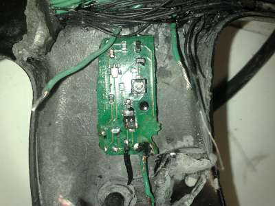

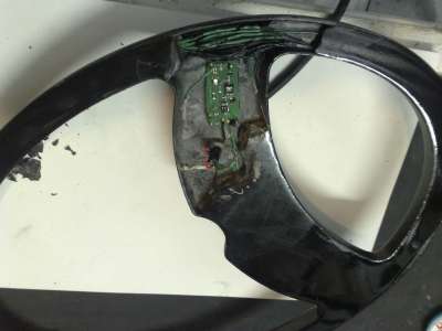

    Hi,anybody got any schematic for this pcb,with smcomponents spec.
    for the 14incher simulated Mono ,Infinium LS coil.
    try again,pics to large?
      Bit of spec. for coils resistance and turns.17t black single strand Kynar type for RX wind,7.60hmm overall.
      Tx.16t green pvc coat multistrand tin plated copper,medium duty wire ,overall,0.6ohm total resistance.
      Graphite coat
      to coil shell,an wire to screen wire to detector coil lead cable.
      graphite coat over all coil winds(both coil winds bound together,one on top of other) in the mono housing,an screen wire to pcb.an coil lead screen wire.
      Tip! for builders try the Infinium DD coil config.but one wind above the other an adjust the internal wind inductance,resistance between winds ,to suit and your Infinium will fire up an work,just fine.will all seen as a DD by your infinium front end and work. OK!
      Turns,Size,coils resistance change per size and much experiment is required.to get the sweet spot.but it does work! Done!No the Detector wont Blow!sustained running in the field now 24Hrs+,Good!
