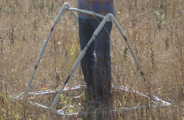

LORENZ 1meterX1meter coil
  • LORENZ 1meterX1meter coil

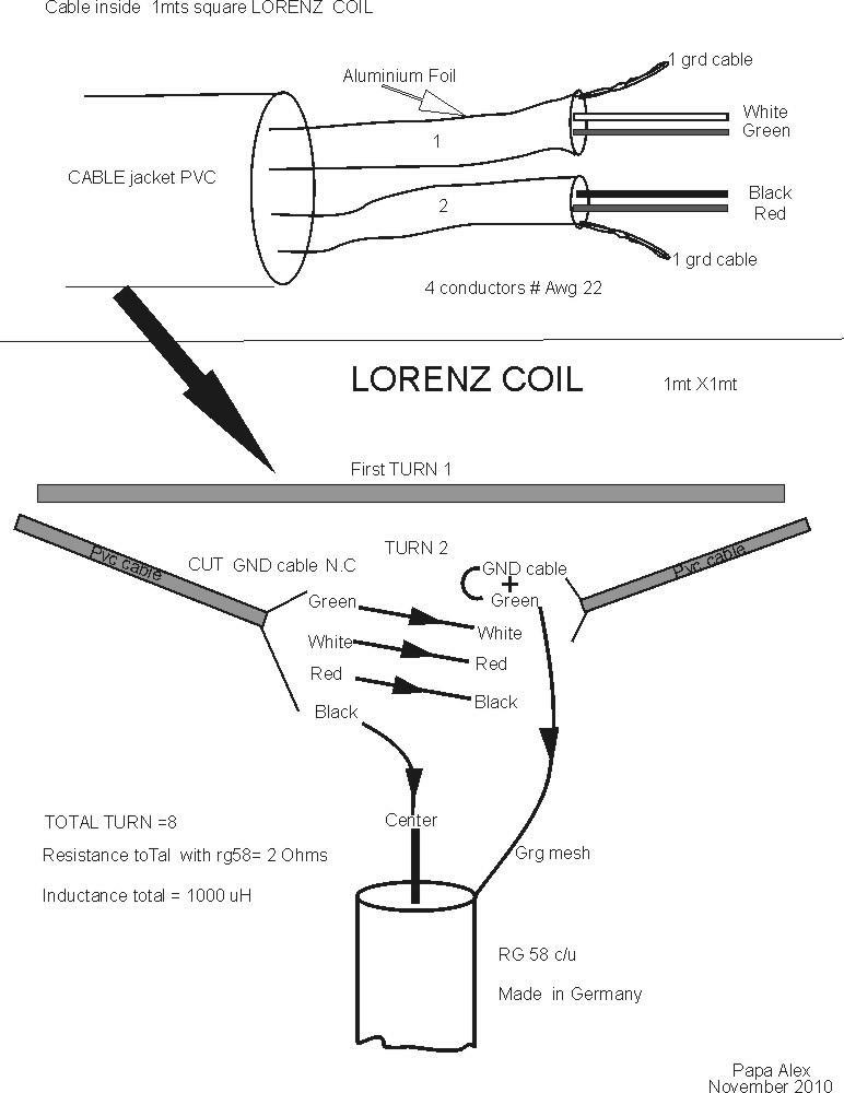

    Here is the connection for the LORENZ 1 meter coil
    Hope it is explicite
    It is two turns of a 4X22 cable * 2 aluminium foil and 2 Gnd
    give us a total of 8 turns
    Resistance = 2 R
    Inductance= 1000uH
    The Gnd cable is connected to the first cable BUT with no loop
    I have reproduced with success this coil with a
    4 X 22 cable with 1 alu foil and 1 gnd cable
    Check the inscription on the cable. On my cable is: BELDEN M 8723 CH 2PR22 SCHIELDED (UL) 5108998 (UL) 1203. Inductance 1x1m (really 1.1x1.1m) frame is 300uH and resistance 2.2ohm. This is the more probable value.

        Mrand , i confirm 100% the inductance is 1093 uH ... and R= 2 Ohms....my inductance meter is very accurate and when i have doubts, i recheck it with a good value reference choke ...
        I understand the trouble of people that why this high value with 8 turns??? (for exemple my 1meter X1meter coil home made with 9 turns of single cable Awg 22 is 545 uH)....
        BECAUSE the high value inductance of the Lorenz coil is due to the cable with foil and gnd drain
        this is exactly the belden cable you say
        Only for the serious .... make your own coil like Papa Alex say..... and you will have reproduced the correct Lorenz coil.....
        For the skeptical, buy your one frame coil from kelly... at $439,95 Dlls

              There does seem to be something wrong with your inductance measurement.
              For a 1m x 1m square coil, the circumference is 4m. If we shape this into a circle then the radius would be 636.6mm. According to the coil calculator:
              8 turns gives 346 uH, which is close to the expected value.
              14 turns gives 1015 uH.
              Although there will be a difference between the square and circle shapes, there will certainly not be an increase in inductance, let alone an increase of around 3X.

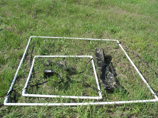

                  those photos I see in ukrainian forum coils are 1 m and 2 m of size.
                    For the measurement it is make in my garden the coil vertically oriented away from metallic object , and like i say i double check my inductance meter with a good accuracy inductor...
                    In some day i will make some photos to upload for the forum,ok
                    Alexis.
