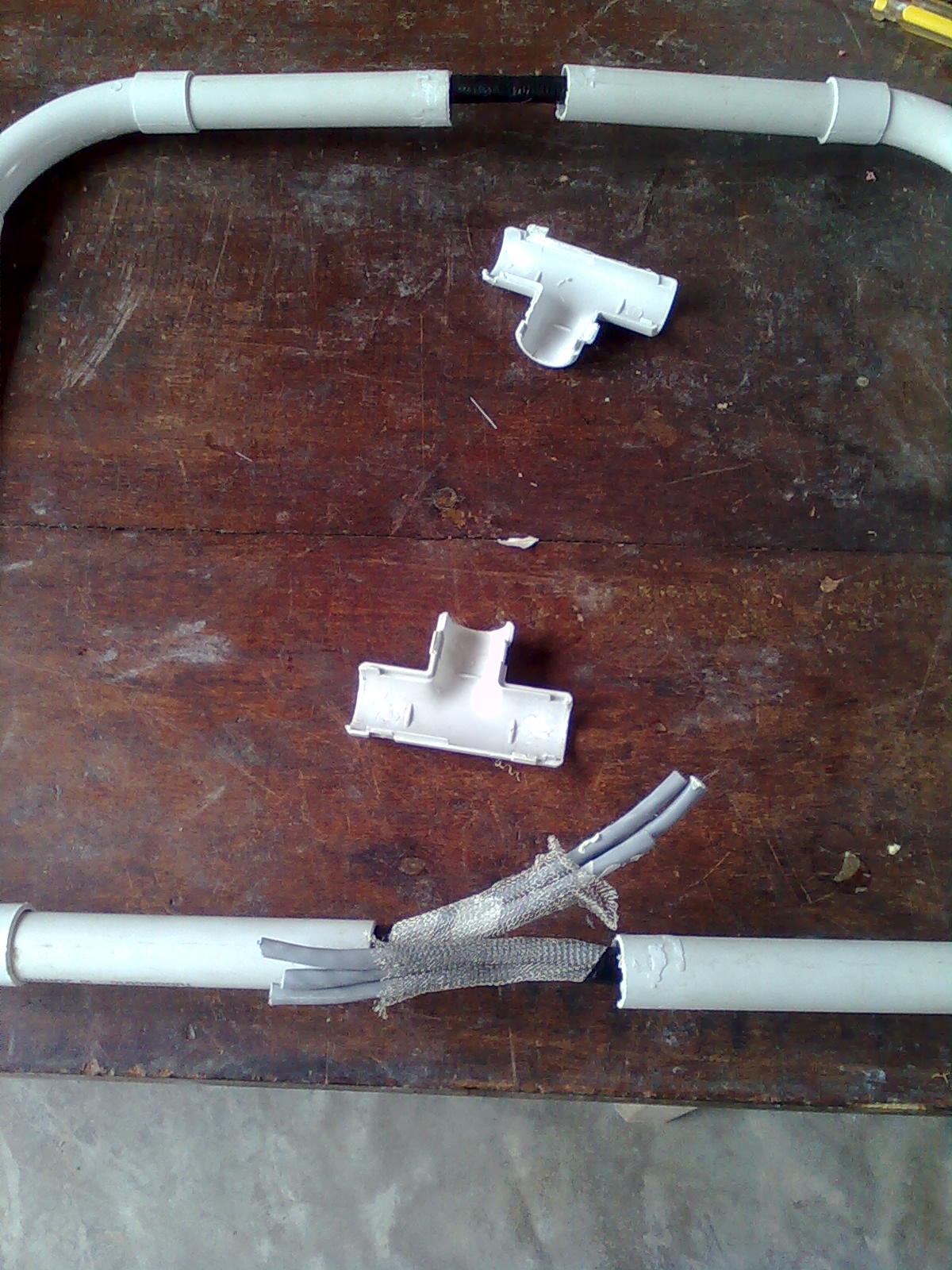

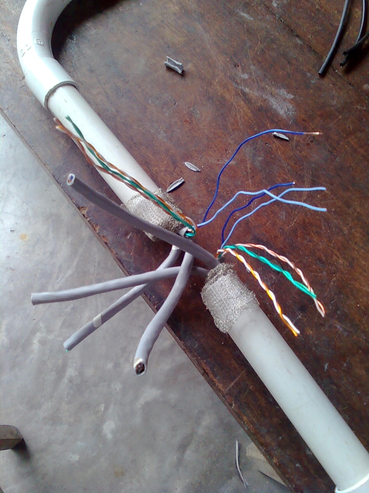

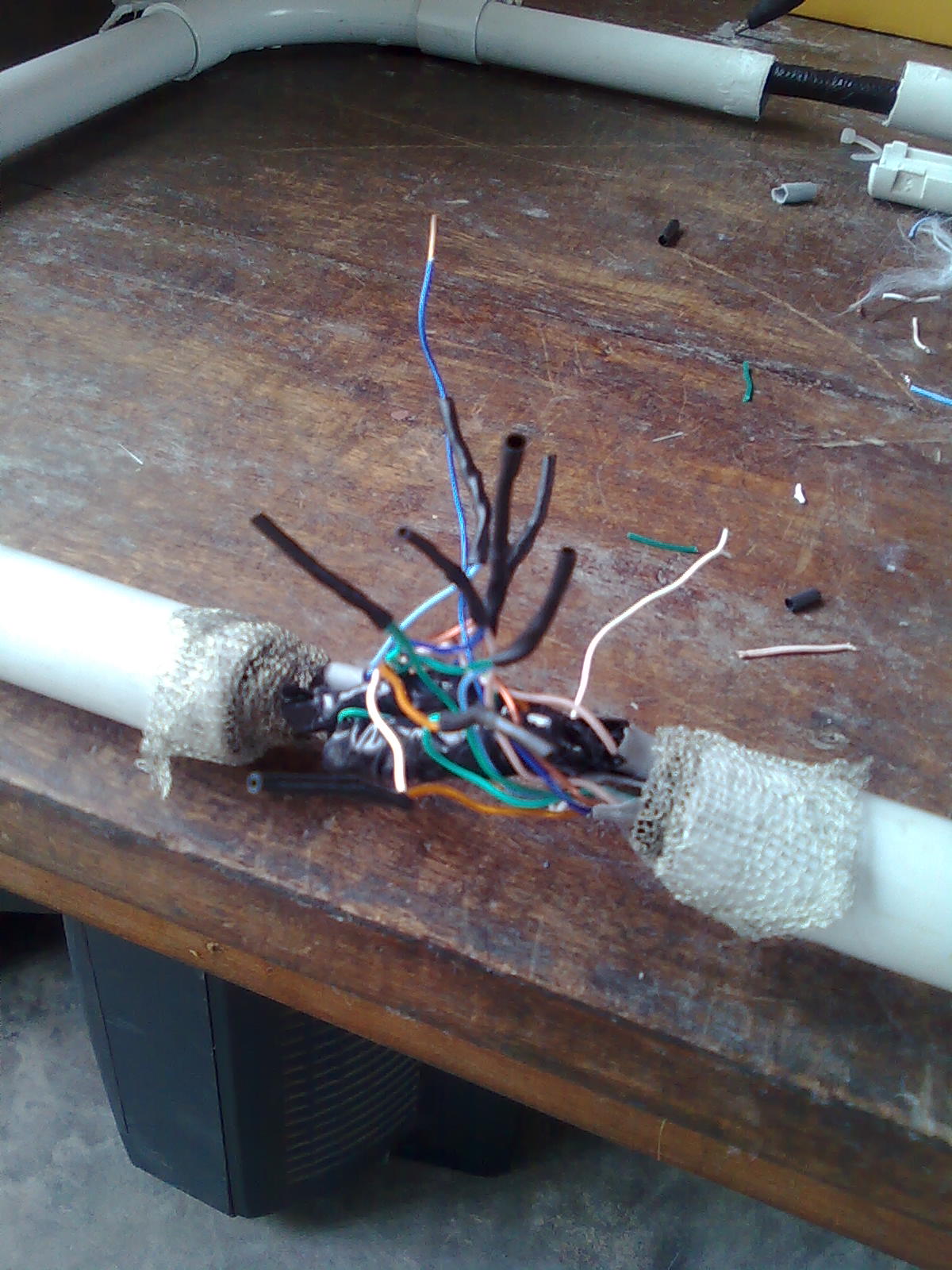

                          Coils 45X45 for DP
                          Coils 45 X 45 for DP
                          Scotch tape shield No. 24
                          UTP cable for computer networks (4 pairs, 8 conductors), 8X3 ... 24 laps
                          Jose
