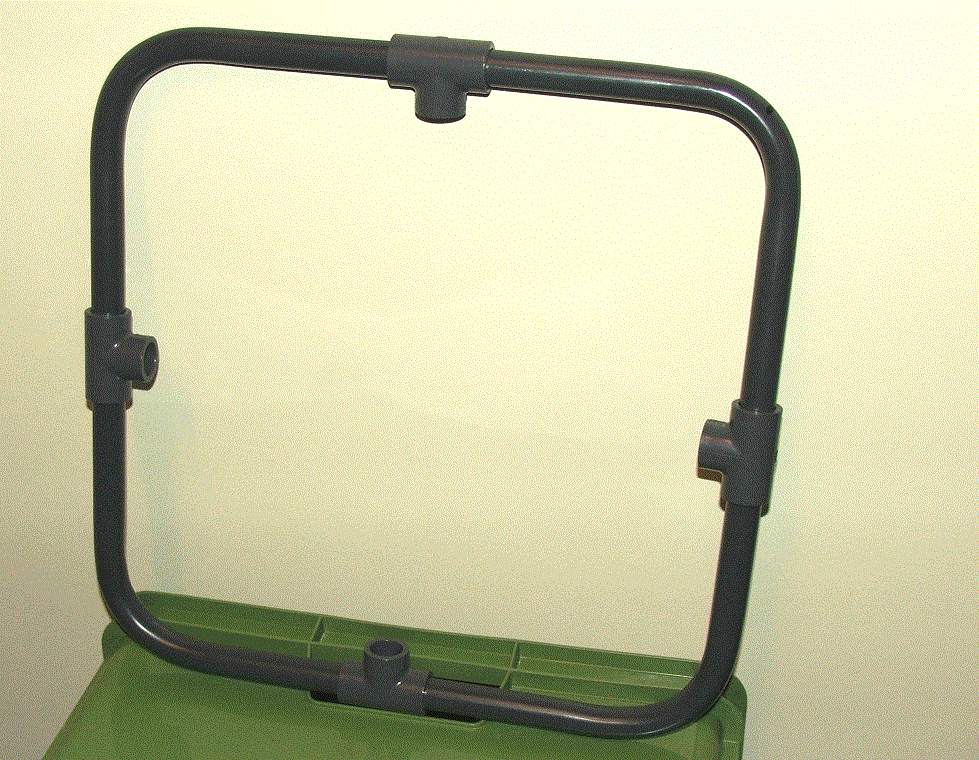

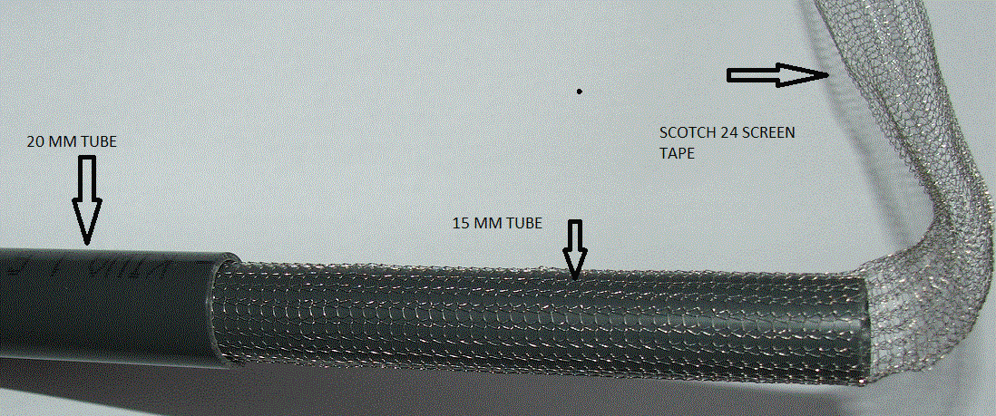

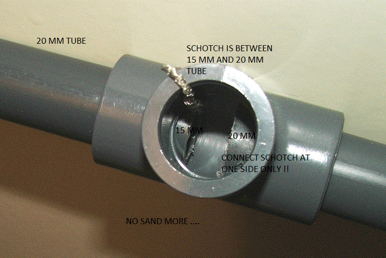

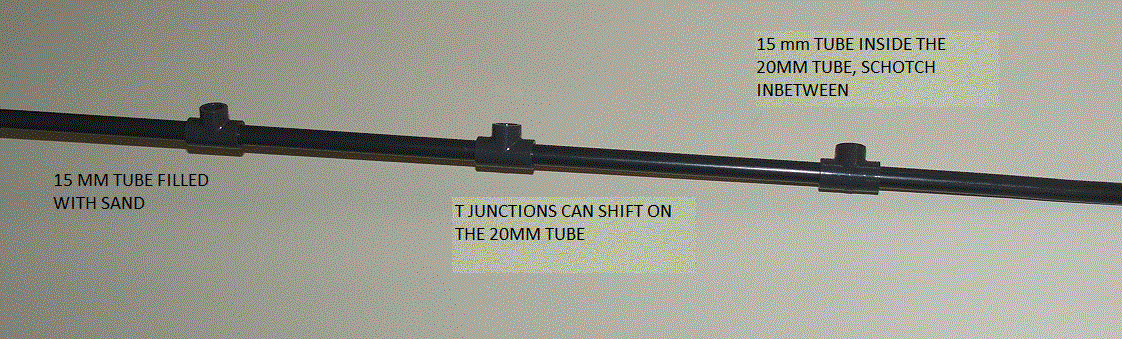

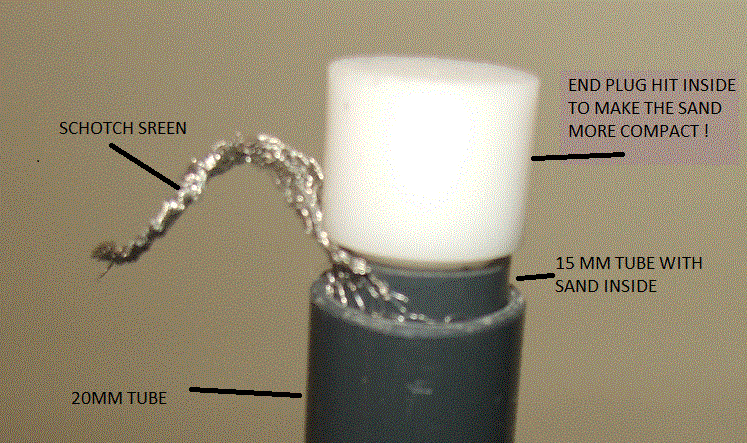

    Hello Friends,
    Made a 40 cm square coil, it needed to be screened…. Well look at the photo’s
    It can be used for a PI detector.
    For the coil that I need it there must be some 140 turns 0.28 mm in it…..I have asked my wife if she has some spare time…. Well you all know the answer I think…..
    Best regards.
    Ap

    Excellent work ApBerg, again.
      Hello WM6,
      Thanks.., hope it can be used by somewone.... some time ago I have seen some cheaper screening tape on ebay, think it came from Tsjechie (Česká republika) not sure...

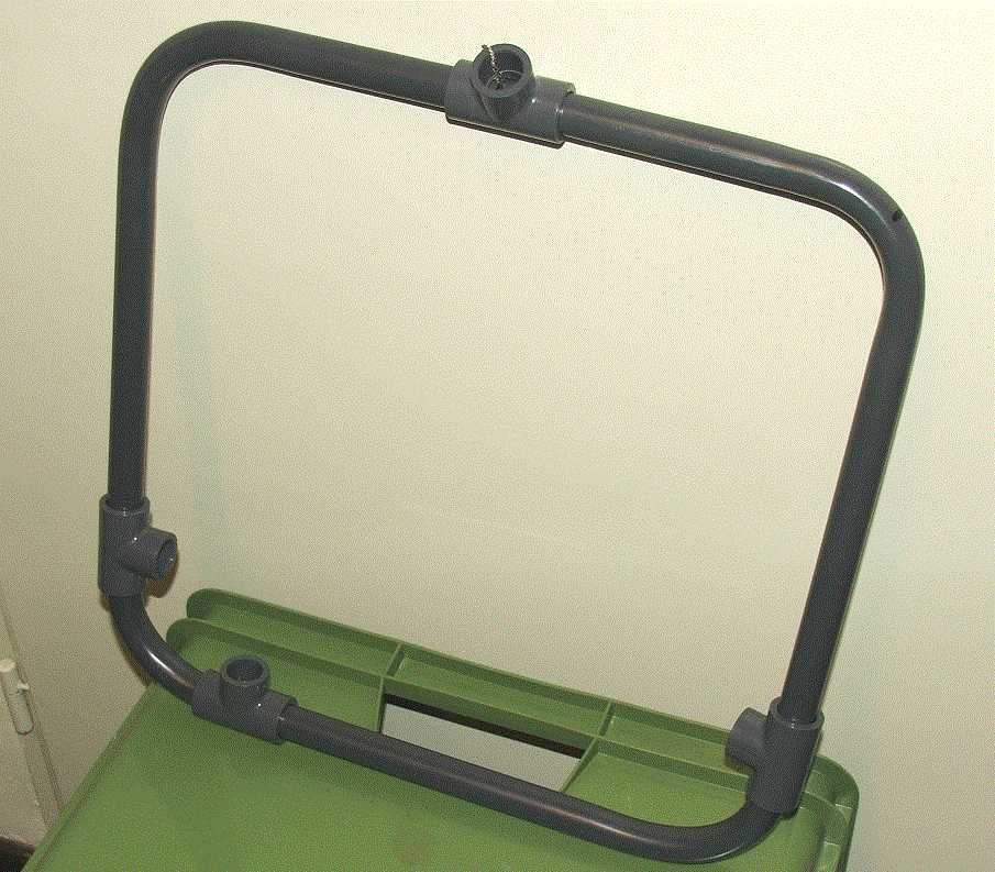

        Nice ApBerg!!!
        Have been thinking of trying something similar myself but using flexible hose covered in foil tape.
        Have formed my PVC tubes - they turned out great, now just got to get the coil in there.
        Thanks for your continued inspiration and wonderful ideas
        Regards Jim.

            Yes... not for a PI detector.... for a Pi detector not so many turns are needed, think I tray to pull 10 wires in 14 turns,and the connect the ends... hope that works.
            Jim; nice that it is a succes, if you shift the T junction over the PVC tube you get a opening, pulling wire is now easy.
