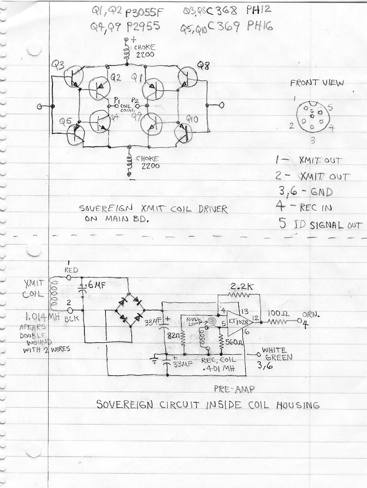

    I'm chasing info on the pinouts and connector used for Sovereign minelab coils.
    Specifically XS 2 Pro models.
    I'm currently playing with a couple of coil projects and i'd like to utilise the same connector and pinouts to ease experimentation with homemade and commercial coils.

    Betobrambi, I have downloaded a sketch, but I don't know for what model is it.
      Thanks Guru

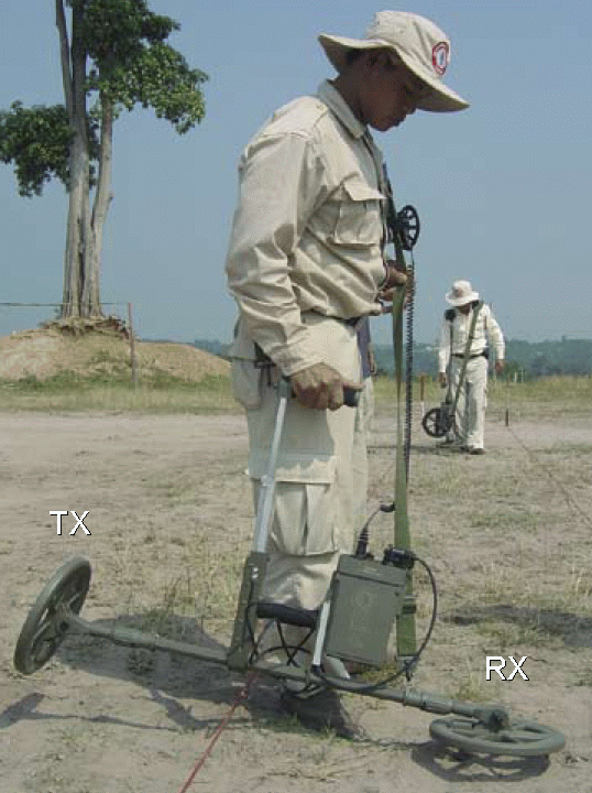

        For deep searching you should use an "almost orthogonal" loop configuration with adjustable induction balance as shown in the picture:

            For example, you do not understand what I mean and what I show in the picture in posting # 4, so I have to explain it again with other words.
            ALMOST ORTHOONAL LOOP CONFIGURATION means that the TX and RX coils are not exactly orthogonal. Note the difference between coil system of your TM808 and the picture of CEIA (posting # 4). Your TM 808 has exactly orthogonal coil configuration, but TX coil in CEIA is slightly tilted to achieve precise induction balance.
            ADJUSTABLE INDUCTION BALANCE means that relative orientation between RX and TX coil can be adjusted. Note that loops of your TM808 are fixed, and its RX coil appears relative high (far from ground). The RX coil of CEIA can be moved near to ground. When you adjust precise induction balance, you can increase the gain of receiver without its saturation. That means more deep.

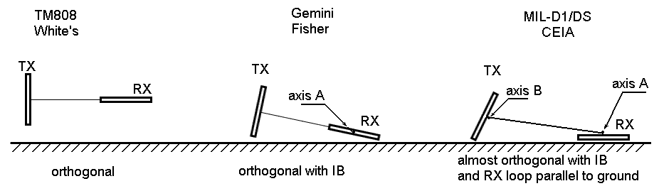

                Attached sketch shows the loop configuration at 3 deep searching models:
                TM808 of White's contains fixed ortogonal loop configuration. The drawbacks are:
                - there is no adjustment of induction balance between TX and RX loop,
                - the minimal height of RX loop is limited by dimension of TX loop and
                - distance of loop system to ground depends on height of operator.
                GEMINI of Fisher has adjustment of induction balance by fine rotation of RX box on axis A, shown as point in the drawing. That alows to be increased sensitivity of receiver. The height of coil configuration can be set to minimum according height of operator. However at this situation the RX loop is not close and parallel to ground.
                MIL D1/DS of CEIA has no mentoned drawbacks. The RX coil can be set parallel to ground by rotation on axis A. Indiction balance can be adjusted by rotation of TX coil on axis B. The coil system can be moved closest to ground by adjusting position of a handle according height of operator (see the picture in posting #4).

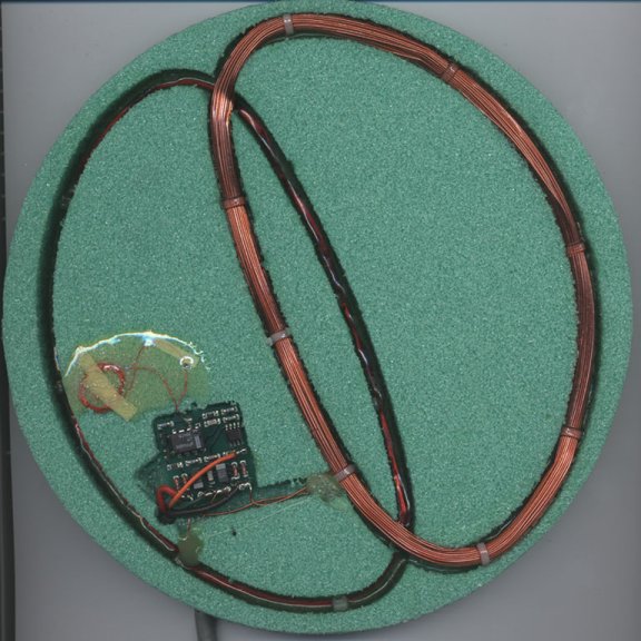

                    Forgive my questions, but the fact is that in reality I want to make a big foot search coil for my Sovereign XS 2 Pro
                    ¿Which are the materials that I occupy to accomplish it?
                    ¿Fellow of Cable? ¿Measure? ¿Inductancy? ¿Ohms?
                    ¿How many turns? ¿What electronic parts?
                    ¿can the Coil have total success in any search's size, utilizing the same inductancia and ohms?
                    must Each bobbin be constructed separately? After,¿To join them in the plate ( PCB )? ¿How is the PCB?

                      Similar circuit diagram
                      God in help.
                      The God is Walter Jung.

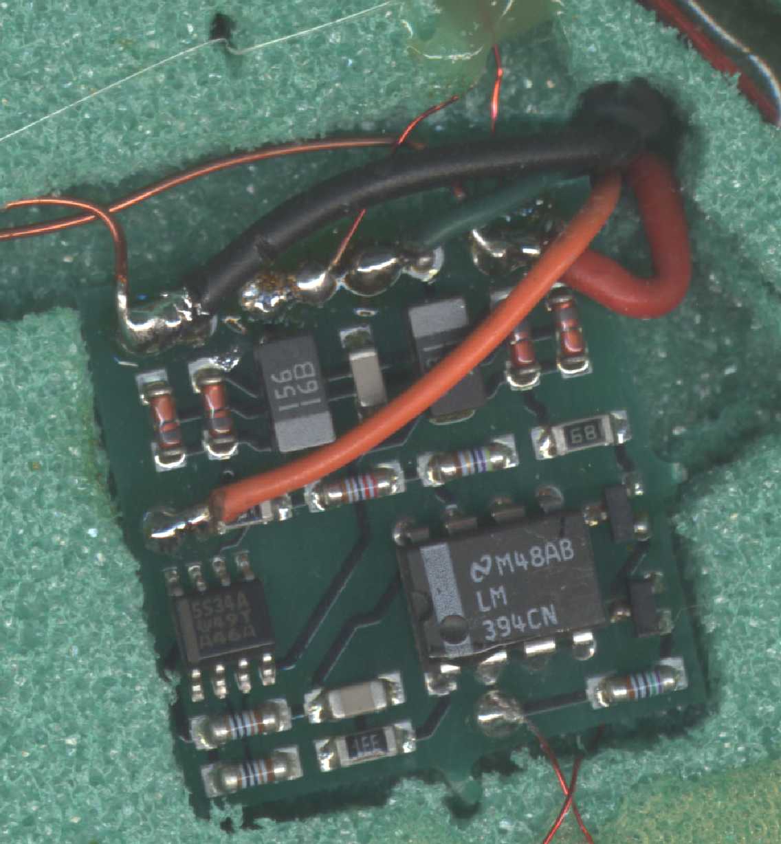

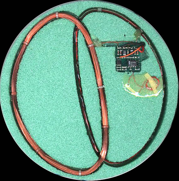

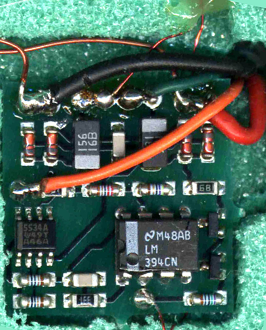

                      Component values in pictures of posting #10 seem similar to values in an old circuit diagram, published by Walter Jung long time before the design of Minelab.
                        The book where the above circuit diagram is
                        "Audio IC Op Amp Applications" has two editions: 1975 and 1978.

                          And to wholes, thank you very much ... I will begin to elaborate a search coil big for my Sovereign ... I Will Delay and in due course, I will get the result of my projects over to to them ...
                          Only a further question:
                          original search's inductance coil Minelab 1000 turned,¿is he the same inductance that I have that to apply in the search coil that I will construct ? ¿must ohms be same ones?
                          That is, if I construct one of 20" inches search coil ¿must I maintain the original coil's same inductance? ¿must I change her and to how much? ¿must I maintain same ohms? Or also I must change them ...

                            You will need to try to have the same inductance and resistance as the original coils as close as you can get.
                            Regards, Ian.
