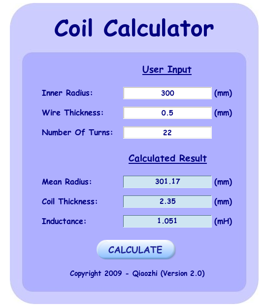

    hello all
    many people built small coils
    but not much information on large and medium-coil
    can you help me to reel 60x60 and 80x80 with cable and enameled wire of 0.5
    Notice to contruction which is managed for you
    thank you for all your help

    60cm dia. = 188.5cm circ. x 22 turns = 41.47mts = 4uH
      Originally posted by berreizeta View Post
      try:
      Use this online calculator to determine the inductance of single-layer and multilayer air-core coils. Both metric and English units of measurement are supported.
      There's definitely something intuitively wrong with that calculation. 22 turns is high for such a large coil, and the inductance cannot possibly be as low as 4uH.
      For a 300mm radius coil with 22 turns of 0.5mm wire, the inductance should be just over 1mH.
      A total of 14 turns will give 442uH, which is a more sensible value.

                Porkluvr and all interested,
                I'll add one more thing to consider when calculating coil inductance.
                The wire insulation thickness determined how far apart the conductive wire lies in relation to the actual space between windings. More space equals less inductance.
                Here is a little trick to better estimate the wire bundle diameter which can be input into a coil calcutalor to more accurately calculate a PI coil inductance.
                Multiply the coil wire OD by a constant of 1.155, multiplied again by the square root of the number or coil turns. This will give you the coil bundle cross-section diameter. Enter this number into a multi layer coil calculation with the diameter being the length and height to the input of the calculator.

                  hello Qiaozhi. can you do same for square coil? or. what coefficient I must use to convert round coil data in square one?
                  TIA
                  Anatolij
                    TIA
                    Anatolij
                    Have a look at this ->
                    If you can build some coils using this calculator and confirm the accuracy of the results, I will create a standalone version.
                    However, looking the formula, I suspect it's going to over-estimate the inductance value.
