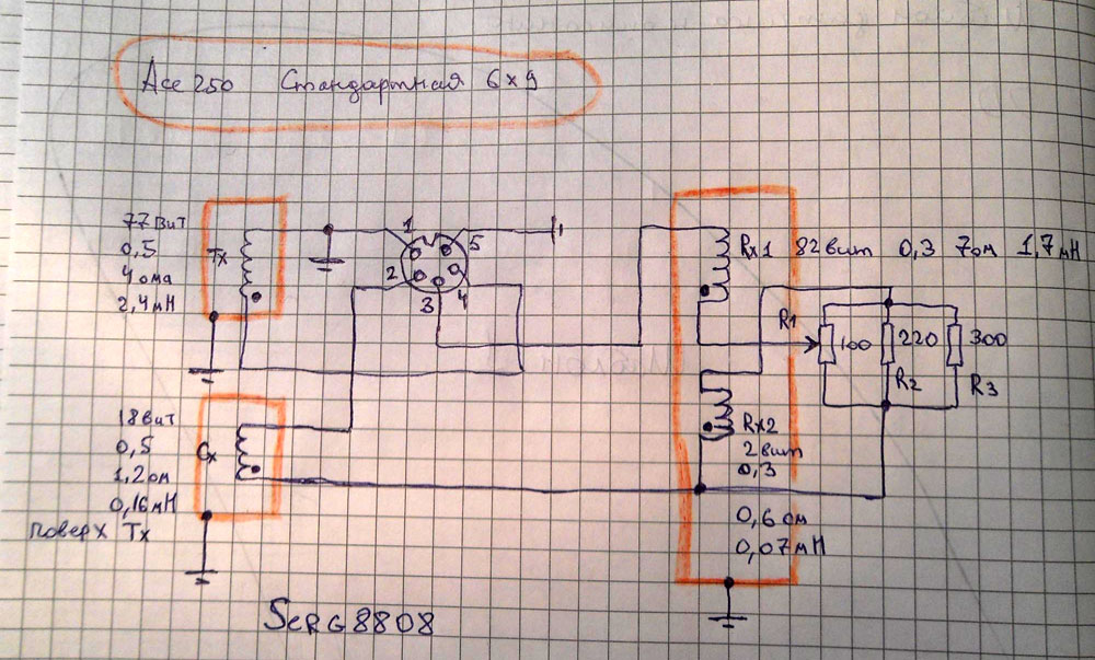

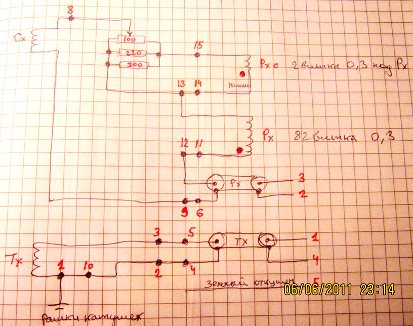

          Homemade Garrett ACE-250 coils
          Coil schematic, recommendations and results for homemade ACE-250 coils you can find here:
          http://www.md4u.ru/forum/viewtopic.php?f=9&t=3542
          I have measured my Garrett PROformance ACE coil 6.5"x9"
          Pins 1-4 TX 4.3 Ohm 2.84 mH
          Pins 2-3 RX 24.7 Ohm 2.63 mH
          You can see different resistance from 15 to 40 Ohm for RX coil because 100 Ohm balance potentiometer is inside of coil.

            Ace 250 coil schematic
            Found one more good Garrett Ace 250 coil schematic
