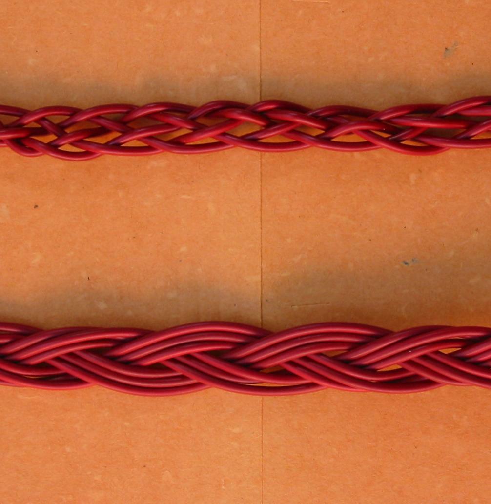

                            Hello Aziz and forum,
                            I have discover when i make my 1 mtX 1mt coil that i can reduce for 15 to 20 % the inductance of the coil with this simple change between have all the cables ties and the configuration braid of the cable (down ) in the photo (3X 3 cables )
                            I put also a five cable braid exemple in the photo.
                            Soon i will make the same for a 16 inch coil to see how the inductance reduce but more work to braid many cables!!!!
                            I just want to know your comment Aziz ,thank you
