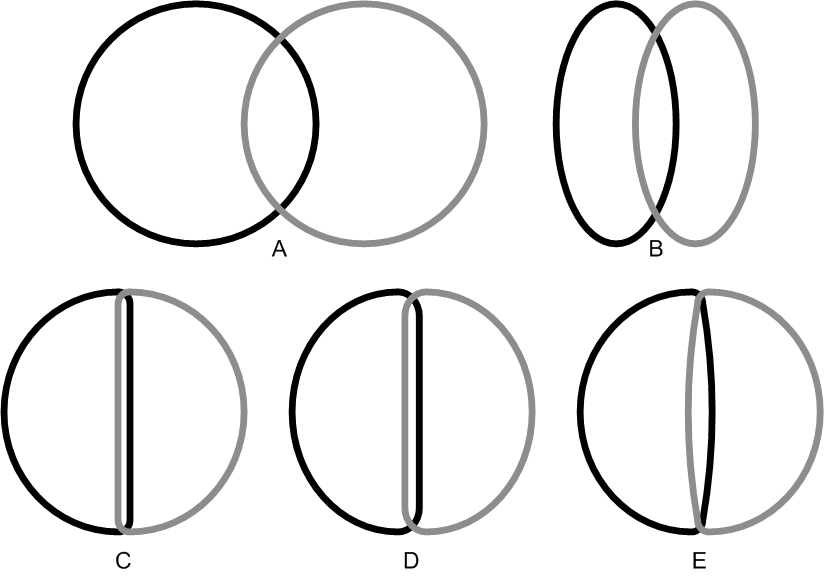

                    The amount of overlap depends on the exact geometry of the coils. Induction balance occurs exactly where the total TX flux cutting through the interior of the RX coil equals the total TX flux cutting outside the RX coil. This is best solved by modeling software (like what Aziz has written) but practically can be empirically determined and probably broadly estimated.
                    Five case are pictured below. The easiest case is for a OO coil (A), where the overlap can probably be figured up mathematically on paper. Coil B is an elliptical 00 coil, and the overlap will depend on the eccentricity. An interested coil designer could surely find a relation between eccentricity and overlap empirically.
                    Coils C-E are DD, but with minor variations. The tightness of the interior bends will matter (C vs D), and bowing the overlaps (E) will also matter. However, the amount they alter overlap might not be significant, I don't know. What's not shown (F) is the elliptical DD coil where overlap will again depend on eccentricity.
                    Bottom line is do what Qiaozhi did... use a known working coil to estimate similar design geometries.
                    - Carl
