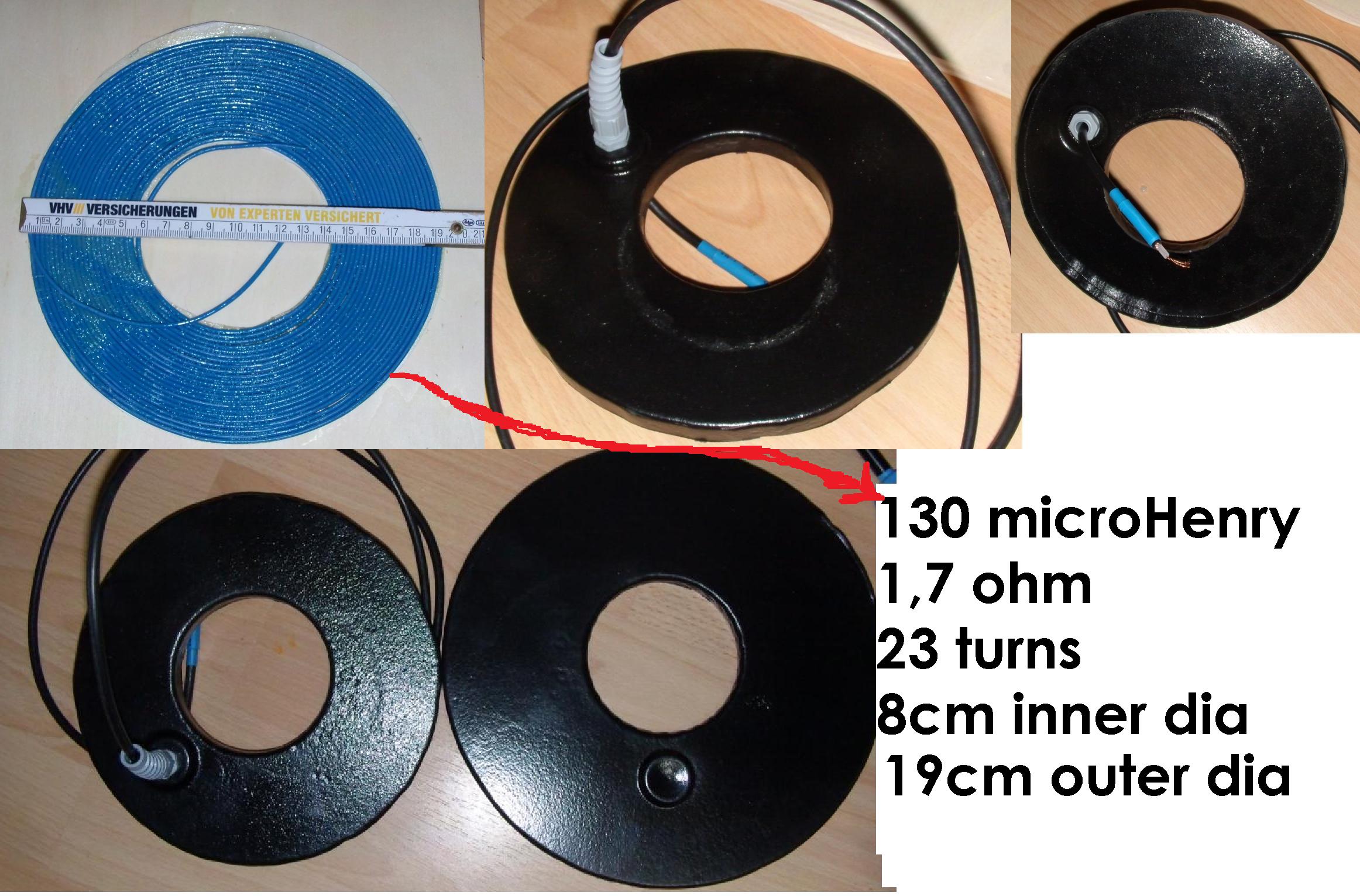

hello
i have to add a second layer to the planar coil i made above
so that are nearly 48 turns
give some more resistance and some more inductivity
and better performance
when the specs are so low like my posting above the tip127 will heat up
thats the first sign thats something wrong with coil
i use wire h05vk 0,5mm (lapp kabel)
