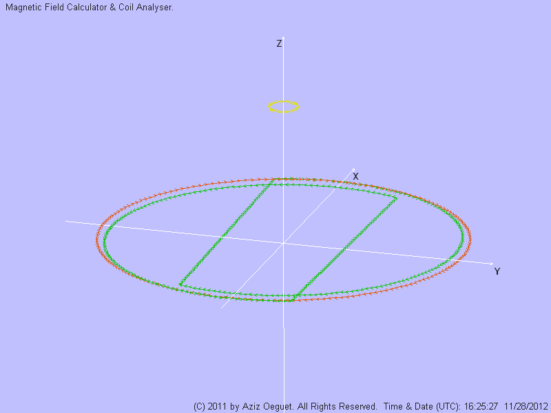

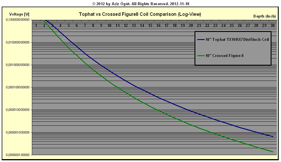

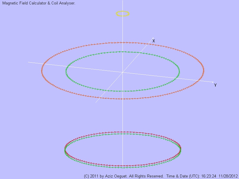

            Ok Ken,
            I can give you the exact answer to your question now, whether which one performs better:
            Either Tophat coil or your overlapped (crossed) figure-8 coil.
            The answer: Tophat coil is performing much better.
            Tophat coil: 10 inch diameter TX, 7 inch diameter RX, 5 inch distance between RX+ and RX-, TX = 300µH, RX = 300µH (total)
            Overlapped figure-8 coil: 10 inch diameter TX, 9.6 inch RX (if round), RX cutting angle 140 ° , TX = 300µH, RX = 300µH (total)
            As the comparison is made under same conditions, don't look at the absolute induced voltages (irrelevant).
            Ok, here is something to see:
            Performance comparison (log-view):

            Sketch of the tophat coil:
            Sketch of the overlapped figure-8 coil:
            Cheers,
            Aziz

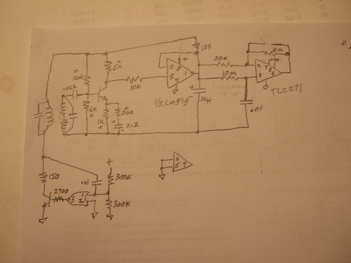

                  I know a little electronics. Not much about metal detectors. I get it working on the bench, then signal to noise kills me when I try to use it. I hope the figure 8 will cancel noise. This time I'm trying to make it simple. I unbalance about 20mv, then measure the voltage change. Signal looks like Surgey's post above. Overlapping or removing some of the circle appears to reduce signal. Works good as long as coil doesn't move. Would winding a more stable coil solve the problem or is concept the problem?

                    What metal detector circuit do you have attached to the coil?
                      What I'm using to play. Modify when I get the detector working.
                      green
                        green
                        The circuit you are using is a very simple TR detector. You should fix the coil overlap in a position where ferrous and non-ferrous targets change amplitude in different directions. If the coil windings are loose, or the TX and RX coils can move in relation to one another, then the received signal will be very noisy. I suspect you initially have a mechanical stability problem, but you later you will encounter lots of other issues, such as ground effect.
