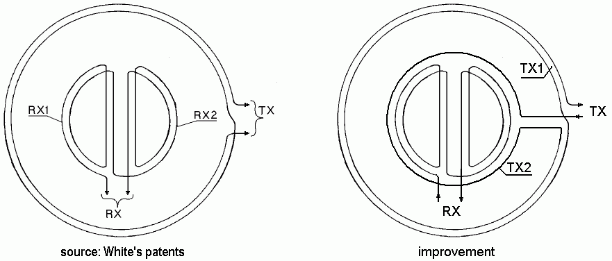

              EEE, in the attached image, both RX windings in left side drawing forms figure of 8 config, which is in induction balance (IB) with the TX coil. However each RX winding receives large AIR signal because is not in IB. This makes difficult damping of RX tank circuit and IB of RX for all operating frequencies. An improvement can be made by adding second TX winding in opposite direction as shown in the right side drawing.
                Hello Mikebg
                Please tell me what would be the optimal relationship between the diameter of TX and RX, in the left figure.
                On the right is according to understand the principles of Dave Emery.
                Jose

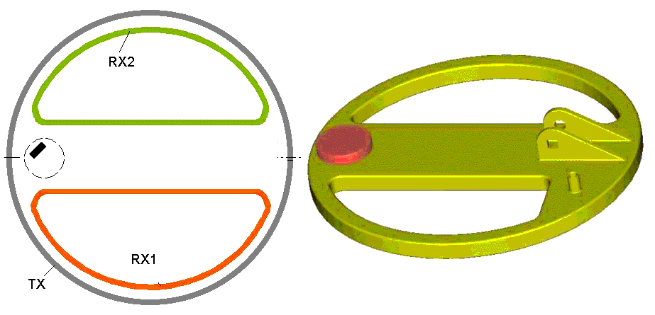

                  Jose, I think that diameter of RX loops and distance between them shoud be increased to achieve maximal depth as shown below.
                    Jose, there is an idea how operator to adjust induction balance in the field. Inside the red knob is placed a core made of metal or ferrite. When operator rotates the knob, the core moves and delivers more signal in one of RX coils.
