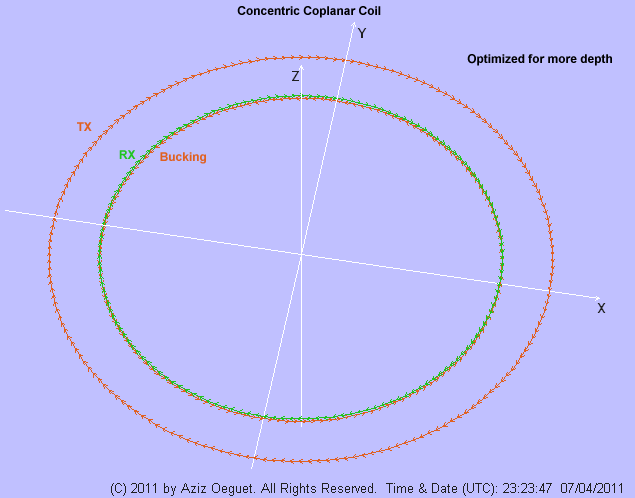

                      Hi all,
                      as you can see (below), one can make more efficient and deep seeking concentric coplanar coils. But it's very important, that the coil coupling between bucking and RX coil should be maximized (coils as close as possible). In this case, the number of turns of the bucking coil decreases and the number of turns for the TX coil increases (for a given inductivity). Additionally, you can make the RX/bucking coil diameter slightly bigger, which effectively has more flux coverage area. In the example below, I could increase the inner diameter up to 0.8 times of the outer diameter. If you make it bigger, the depth performance decreases then. So you should experiment in the range of 0.7 .. 0.8 times the outer diameter.
                      Anyway, this coil is not for beginners. It's quite difficult to build (to me too). I personally wouldn't invest the effort as there are much simpler coils there.
                      Cheers,
                      Aziz
                        cheers aziz for putting in the effort into an old design.
                        i'll think i'll poss move away from the idea then , thank you for you input.
