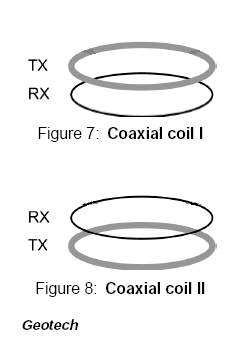

    Hi all,
    I am just wondering, what happened to the coaxial coils (see below)? They seem for a quite long time not much popular anymore. What's the reason?
    Aziz
    Source:
    Coil Basics
    by Carl Moreland
    Can be found on Geotech somewhere.
    Garrett used them in their early VLFs, and C&G Technology used them, too. They are much thicker than coplanar coils, and tend to be heavier. Also harder to build, as the IB happens in 3D, whereas coplanar has a simpler 2D balance. This means more expensive.
    However, they work great under powerlines and along metal fences. In fact, we had a utility customer who needed to detect right up to a chainlink fence, and no regular coil would do it. So we built him a special coax coil for his MXT, and it worked perfectly.

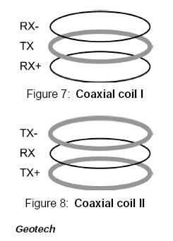

            Hi WM6,
            I did dozens of them last days.
            Therefore I was quite positiv surprized about the magnificient depth performance and the ease of building such coils. Balancing is made by purely varying the distance of one coil, which makes up the thickness of the coil at the end.
            It would have a better response to highly mineralized soil as the transmit coil is quite above the ground. The hot rocks/ground won't be magnetized much and could reduce the ground noise.
            Unfortunately, the thickness of the coil is related to it's diameter. A bigger coil needs more thickness of course. Could be a problem in the terrain usage.
            Nevertheless, the coaxial coils can be made to outperform every IB coil for a comparable given inductivity and coil coverage surface. But you need to modifiy the architecture slightly to reduce the thickness of the coil.
            RX- (less turns, very close to TX, RX- & TX fixed tightly together)
            TX
            Gap for fine balancing
            RX+ (more turns)
            Ground
            Cheers,
            Aziz

              BTW,
              the other configuration (TX-,RX, TX+) is also possible of course.
              TX+ (more turns)
              ..Gap..(balancing)
              RX
              TX- (less turns, very close to RX, fixed tightly together)
              Ground
                TX
                RX+ (more turns)
                This will work for achieving IB, but it will negate the two advantages of the coax arrangement: interference cancellation, and the edge-null for hunting next to metal posts. Both of these require equal RX+ and RX-.
                  Yes, that's right.
                  But the asymmetrical configurations decrease the coil thickness. You can decrease it more at the cost of depth performance of course.
                  I like the coil configurations, as these are definitely very easy to build (for me). And I can build much bigger IB coils (as tight frame coil with two tires).
                  Aziz

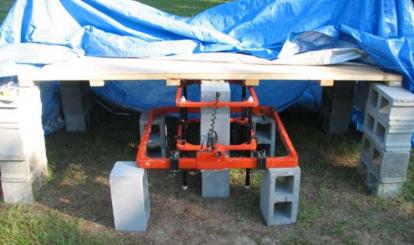

                    Hi Aziz, look at this hidden testing plant of such coaxial (two man operating) coil.
                    It can completely eliminate all Ferro particles and hot soil to 1.7 meters of depth - dream for you:
                      Hi WM6,
                      this ain't efficient enough!
                      But goes into the direction of what I plan to do.
                      It's quite difficult to get the appropriate plastic rods. So I want to do it with wooden rods first (quite cheap and easy).
                      I'm investigating how to make a thread in the wood for the plastic bolts. It's obviously possible to glue a metal bolt into the wooden hole and screw it out when dried (epoxy glue). This gives a tight thread. If the metal bolt is oiled first, then this would give a much better thread I think (easy to screw out).
                      The wooden rod is a distance spacer. Two rectangular wooden frames with tight fixed coils will be assembled together. The distance spacers give you some amount of adjusting range to get the balance of the coils. This could be done with some flexible (soft) gum or tight XPS foam.
                      Two plastic tires will be mounted to the frame coil (pushing and pulling the coil).
                      That's it.
                      Aziz

                            Hi Aziz. Why do a combination of three coil (TX-RX-TX or RX-TX-RX). Is not it enough combination of the two coil (TX-RX or RX-TX). The smaller dimensions, lighter weight, easier to balance ...
                              Hi Maikl,
                              these versions wouldn't work in our IB configuration. The RX coil would induce a much higher voltage from the TX coil. That's the reason, why we need bucking coils (either RX or TX) to cancel the high induced voltage. We just want a few mV (or just a few tens of mV). Perfect IB would mean: 0 V induction from the TX coil.
