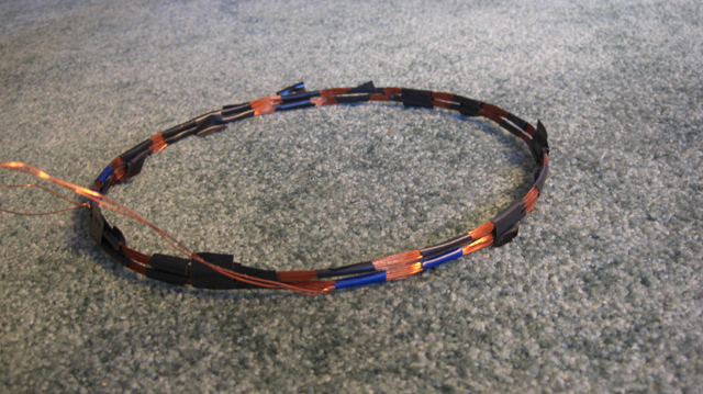

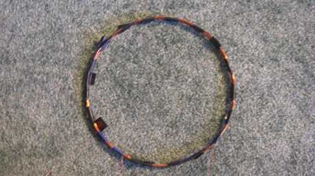

                  Being impressed with how often my intuition is wrong in this business, especially with coils, I decided to tempt fate once again. I was not disappointed.
                  My latest experiment (inspired by a picture mikebg posted of a search head with three coils) involves testing the combined inductance of two identical circular coils, in various connection configurations and amounts of lateral separation.
                  My original intent was to measure how the combined inductance of "cancelling" coils (connected in series with current circulating in opposite directions) varies with lateral separation. Can you visualize that??? I can't.
                  My speculation was that if the coils were centered at the same point (100% overlap) and one resting on the other, the inductance would be near zero. When separated by a good distance, the inductance should be L + L (sum of the inductances of the identical coils).
                  It's all about flux, I figured. It seemed to me that the two coils should share at least 95% of the flux if stacked as close as possible (but maybe looks are deceiving). And if the current circulates in opposite directions, the fluxes should cancel and the inductance go to near zero.
                  But flux has me flummoxed, as usual.
                  Well, yes and no.
                  Here is my conundrum wrapped in an enigma and dropped in a quandry basket: the inductance was not near zero but slightly more than L/2 !!!!!
                  What, you're not amazed? Let's think about it. Take a different case altogether: If I had two identical coils in parallel not sharing any flux (no mutual inductance), the combined inductance should be L/2. But these coils, albeit in series, are smack-dab slapped up against each other and phased in opposite directions. I would have sworn on my mother's bobbin that they should cancel nicely and have at most L/10 combined inductance.
                  But I was wrong...shocking...
                  However, I tried one other gambit, now connecting my stacked coils in parallel, still phased in opposite directions (as before) to cancel each other.
                  The combined flux was now approx L/7. Better, I guess. Maybe.
                  So I decided to study this one physical configuration (coils 100% overlapped) and take some measurements while connecting the coils electrically in different ways. I hereby present you gentlemen (and ladies?) with the results and scant further analysis.
                  Pictures of the coils are below to assist in pointing out the flaws in my thinking.
                  Coil(s) description:
                  Diameter: 22 cm
                  Turns: 20
                  Wire: 24 AWG
                  1. L1 Inductance of coil1: .251 mH
                  2. L2 Inductance of coil2: .255 mH (virtually same as L1)
                  3. L3 Combined inductance coil1 || coil2 (parallel), phased opposite: .038 mH (15% L1)
                  4. L4 Combined inductance coil1 || coil2 (parallel), phased same: .214 mH (85% L1)
                  5. L5 Combined inductance coil1 -- coil2 (series), phased opposite: .156 mH (62% L1)
                  6. L6 Combined inductance coil1 -- coil2 (series), phased same: .858 mH (340% L1)
                  Scant analysis:
                  Case 3 seems somewhat predictable, very low inductance with coils in parallel but phased opposite. I would have expected less than 15%, but flux has a way of leaking more than you think.
                  Case 4 fairly predictable - two identical coils with 100% mutual inductance should have same inductance as one coil but half the resistance. 85% is ballpark.
                  Case 5 - this one fooled me, I thought it would be more like Case 3. Ideas welcome.
                  Case 6 - need Qiaohzi's calculator for this one, but basically conforms to the power law of windings and inductance -- double the windings gives much more than twice the inductance.
                  Using Q's calculator:
                  Inner Radius: 105 mm (using 21 cm inner diameter)
                  Wire thickness: .511 mm
                  Turns: 20
                  Inductance: .252 (spot on!)
                  Turns: 40 (two coils stacked 100% overlap)
                  Inductance: .939 (compare to .858, not bad, considering leaking flux)
                  So it is really Case 5 that beguiles me. I have a feeling that some calcs using mutual inductance might explain it.
                  Cheers,
                  -SB

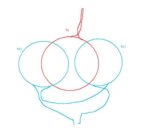

                          I don't expect this particular configuration to be deeper or easier to use, but the main objective is to see if it reduces EMI noise which is a big problem in certain areas. And who knows, any design has surprises.
                          I think the next step I'd like to try is, instead of two identical RX coils, to have a main RX coil in normal double-D configuration, plus a small "EMI sniffer" coil mounted above whose purpose is to sample the EMI noise, and then try to electronically subtract it out in the preamp.
                          I encourage you to try building a prototype also because I'm not great at construction and may get poor results because of my lack of workmanship.

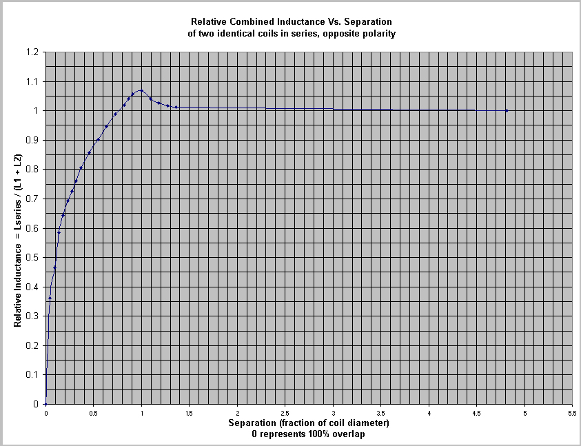

                          I made some quick measurements of "combined series inductance vs separation" of two identical circular coils, connected in series but opposite polarity, separated by varying distances.
                          Zero distance means 100% overlap -- coils centered at same location.
                          I normalized the separation distance to be a fraction of the diameter of the coils, so the graph could be more easily used for other coils. I also normalized the inductance to be a fraction of the sum of the inductance of each coil. I also cheated and put a point at 0.0, 0.0 as if the coils perfectly canceled when 100% overlapped. In reality, my coils had a value of approx .32 . I used the idealized value because if you press the coils together
                          you can get lower inductance, and flat coils would probably have less than jumble-wound, etc. Anyway, we're not too interested in coils with large % overlap because they cancel each other too much.
                          I will probably choose a configuration with the coils separated by just over a coil diameter -- in other words, side-by-side and touching.
                          This corresponds to a separation of around 1.0 on the graph.The inductance peaks near this point --hopefully I can estimate the inductance well enough.

                            One interesting point of note on your graph is the point at a spacing of approx. 0.8, where L =1.0. This is the null - point, where mutual inductances neither help nor hinder the performance. This is where IB search-coils would be fixed, if they were circular, eg.Nexus type.
                            Unfortunately, my tests were concerned with spacing the two coils with them still concentric.
                              Interesting point. I don't know if there is significance for dual RX coils (other than makes calculating desired coil inductance simpler). Picking the max inductance point means less wire to achieve a given combined inductance, but that may be irrelevant to the ultimate goal of sensitivity to target.
                              I'm more and more feeling that such a dual RX design with opposite polarity coils connected in series is just not a great idea, other than hopefully reducing EMI noise. Each coil has about half the inductance and therefore probably half the gain of a single coil with the combined inductance. And because you don't take advantage of the square law of inductance, you have more wire in two coils than a single coil, meaning heavier search head.
                              Still, I'll try it to see what happens, then go from there with other ideas to suppress EMI.
