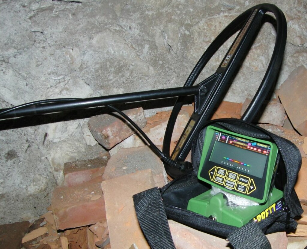

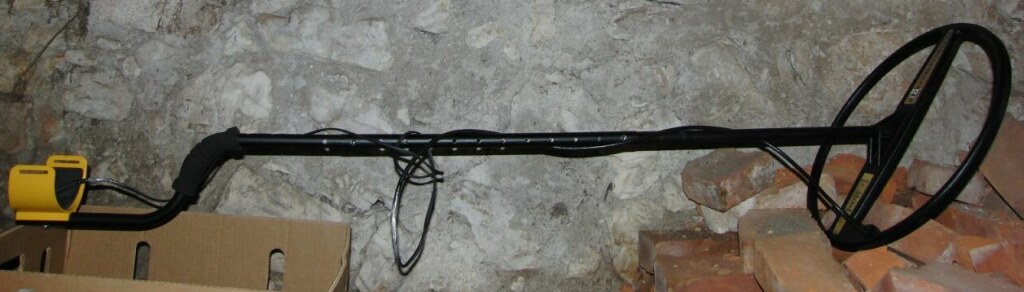

                            Below you can see my current lightweight solution for steep mountain search:
                            120cm long holder: 400grams
                            45cm Excelerator coil: 850grams
                            (modified Garrett GTI 1500 inclusive batteries and bag: 970grams)
