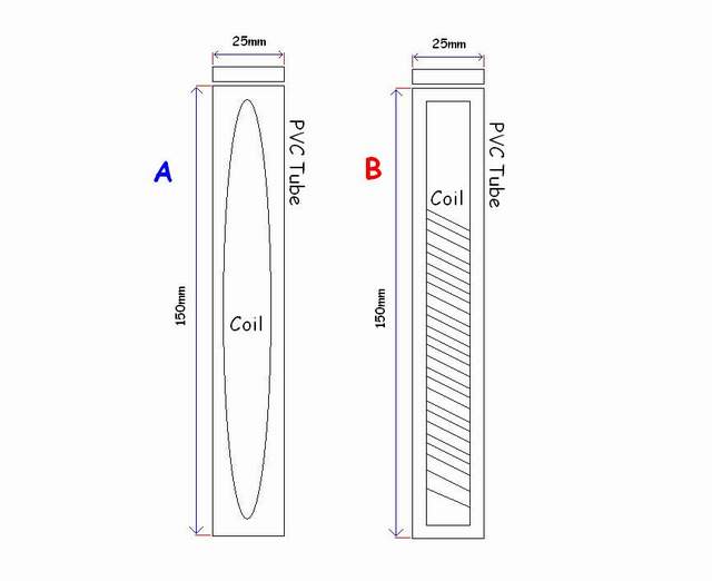

To all PI experts here on forum,
there is pretty concrete problem i have to solve.
Have Barracuda or Surfmaster as PI detector, need special coil for special tasks.
Coil is supposed to be mounted in PVC pipe.
I need highest depths or distances possible to achieve with such coil.
Coil supposed to be involved in hole in soil and lowered as much as cable allows (2.5 meters cable is planned).
It doesn't really matter from which side coil will be more sensitive , but what is important and desirable is to achieve highest possible detection distance on small items such as coins and similar.
So i tried to make coil as on example "B", but couldn't achieved more distances than 5-6cm on single coin... not satisfied.
Now i am thinking to try example "A" coil setup.
Any suggestions? Hints? Experiences?
