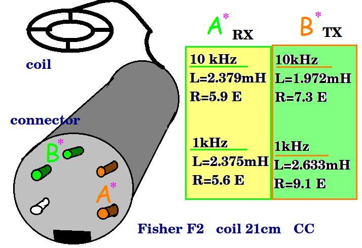

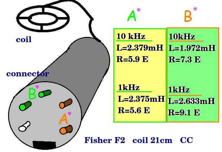

        Geo, to measure inductance is not problem. Measured at two different frequencies (1kHz and 10kHz).
        As you can see from data there is not only "inductance" in coil.
        I do not know which is TX and which RX, without coil TX oscillator do not oscillate and I haven't such connector by hand to test oscillator with such inductance.
        Maybe you know contact configuration?

            The coil spec is the same as this one, apart from the receive coil resistance being a little different( 5 ohms instead of 8 ):http://www.geotech1.com/forums/showthread.php?t=17905

                Thanks Skippy. Then B* pins are TX, cause A* pins (windings) do not change inductance related to frequency. Capacitance is then added to B* windings.
                  The F2/4 coils are electrically the same series as the regular Bounty Hunter coils. Don't have the exact data in front of me at the moment, but both the transmitter and receiver windings are approx. 2.4 mH. The transmitter is parallel resonated with a .22 uF capacitor to resonate at about 6.7 kHz. Therefore at 10 kHz the transmitter reactance is capacitive whereas the receiver is still inductive.
                  To get good induction balance, the windings must be phased correctly. Sorry, don't have a connector pinout handy.
