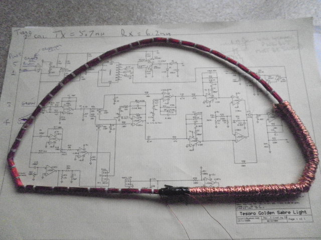

    Hi had very good results using Tesro spec coil inductance 5.7/6.2mh, black wire n/p shield return for RX/TX, coil socket on MD bonded to earth.
    Trying this method too reduce chatter on ground tests using silver dogs mod for more depth.
    Using shield braid from a good quality TV coaxl cable wound directly onto coil windings.
    Will let you all know results soon, Watch this thread

      Yes it could well be bernte, infact in theory it is, but worth the experiment in real use dont you think?, so many theorys over the years have been proved wrong in practice.

          I also tryed aloy tape and that was crap, best ive used so far is mylar, just trying for that extra mile.
          The braid im using is just wound on tight with twin stick each end so will be a 30secs job to remove and the cables im using is from lenths left off from drums in the workshop, so theres know money outlay at all just a bit of time.

            It works, I've used in at least 5-6 coils for VLF and a couple for PI; the braid solution is good as could be good using layers od litz wire over coils, it's also really cheap compared to mylar solution
            what's important in shielding the coils is that very small currents may develop in the shield and there is a gap, somewhere, and not closed loops (unless conductivity is very low like with graphite)
            if use copped tiny wires braid (like from coaxial cables for TV or radio stuff) gain good results this way, sometimes using silvery braids things get worse this way depending on wires material
            it's a cheap alternative to using aluminium foil e.g. for kitchen purposes, that's thick and much respect to mylar layer
            mylar is the best cause shields from EMI and gives enough conductivity to create a ground plane under the coil but is not cheap and not easy to apply most o the times
            another alternative is using graphite, graphite based putty (like aquadag varnish), nickel spray or other conductive paints (e.g. based on copper or silver), and for PI the best is lead tape very thin (used in some satellites and military US things... expecially of 60-70s)

                    yes, I think it's worth a try if one is making coils for PI detectors
                    there is also this one from 3M , don't remember well about required thickness for shielding but think something from 2 mils to 6 mils (say from 0.05 mm to 0.15mm) or the like could be ok
                    I think anyway that the smalle the thickness the better cause of lower conductivity of the shield wrap, think in Eric Foster's coils was around 2 mils but not sure about
