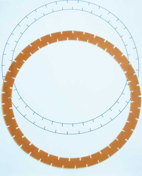

    I need some info (measures) to build this type of coil for the Chance Unit
    Does anybody know the measures of this coil? (I mean radius, space between cuts and number of turns...)
    Thanks in advance.

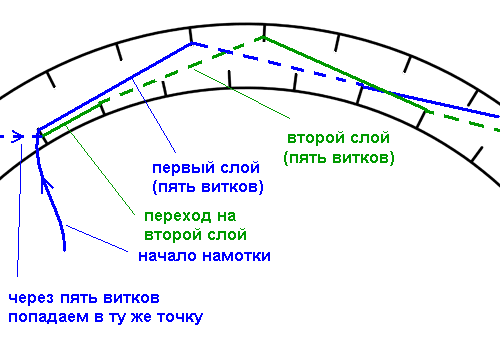

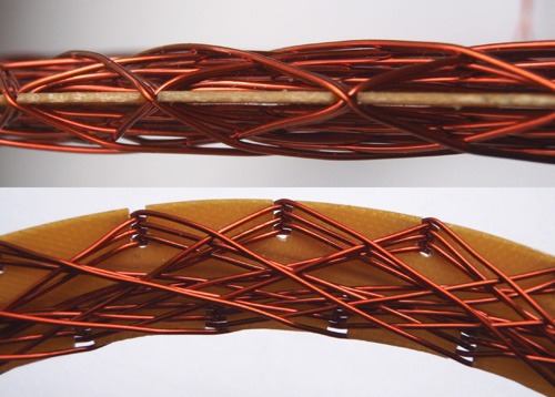

          This is 3-dimensional zig-zag wound coil.
            Thanks to WM6, I was able to find these.
            The Idea is that this fashion of winding produces less inter wire capacitance and will make for a faster coil.
              Hi thanks for your help,
              While searching the web I've found a printable for the ultra fast coil as well as detailed info about building the coil.... now I need to find a suitable material... (cardboard is a bit soft and I don't like to made it of wood so I'll try to get a piece of plastic.....)
              Thanks again.

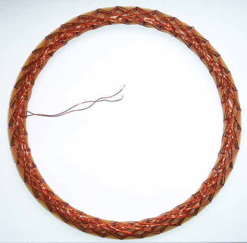

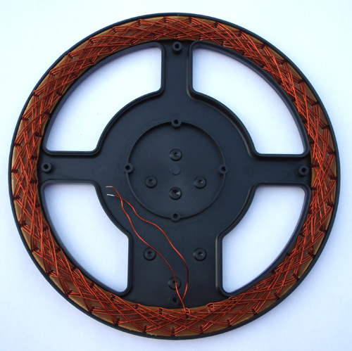

                    I have built a couple of these,.... I printed out the template, stuck it to a cardboard former,... cut out, and off we go.......
                    I wound one with 22 SWG copper enamelled,... and one with 24 SWG,... (see pics here,... post 29....) I potted it in resin, then coated with thin, self adhesive copper foil,..... I am using it on a Surf PI board,... but am a bit disappointed to be honest,... inductance, and DC resistance seem ok, but I am getting poor sensitivity,... but I could well have made a BooBoo!!!
                    The poor results could be due to a fault on my board build, due to the fact that I dont know WTF I am doing,..... but I am working on it??!!??
                    I will photo the finished ones, if you like, they were lightly 'drizzled' with resin,... then covered with thin copper foil,.... fairly light, and nice and stiff,.. just dont pick owt up!!! LOL!!
