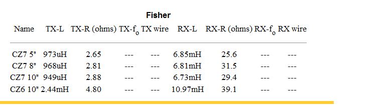

    Hi folks, I'm looking to make a 4" sniper coil for my Fisher f2. does anyone have any specs on this coil such as wire size and uH of RX TX. thanks
    Only info I know of on fisher coils.
    I don't know if the coils are the same as the F series.
      Thanks for reply Homefire, I saw these specs on the forum as well but not sure they would work. On Fisher's web site the only coils I see that are interchangeable are with the F4 which is basically the same detector only with manual ground balance and a few more display segments than the F2.
        Read this http://geotech1.com/forums/showthread.php?t=18130
        My 4" coil for F2 has 2.4mH imbentance and 7.8Ohm dc resistance.

            Geo, thank you for reply. That's the info I'm looking for thanks for help. How do you like your F2 ? I just bought mine a few months ago and find it's excellent detector for the money.
