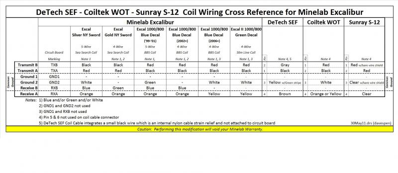

Replacing sea search coil on an old my NY Excalibur sword.
The wiring instructions I have use five wires. The coil has six red and ( black power)
Green/ orange/ red +/ /black- /blue /and/ white
I'm thinking that the green wire would be another ground to the board ?
Or can it be terminated at the coil or grounded to the power ground black - ?
Any help would be appreciated
