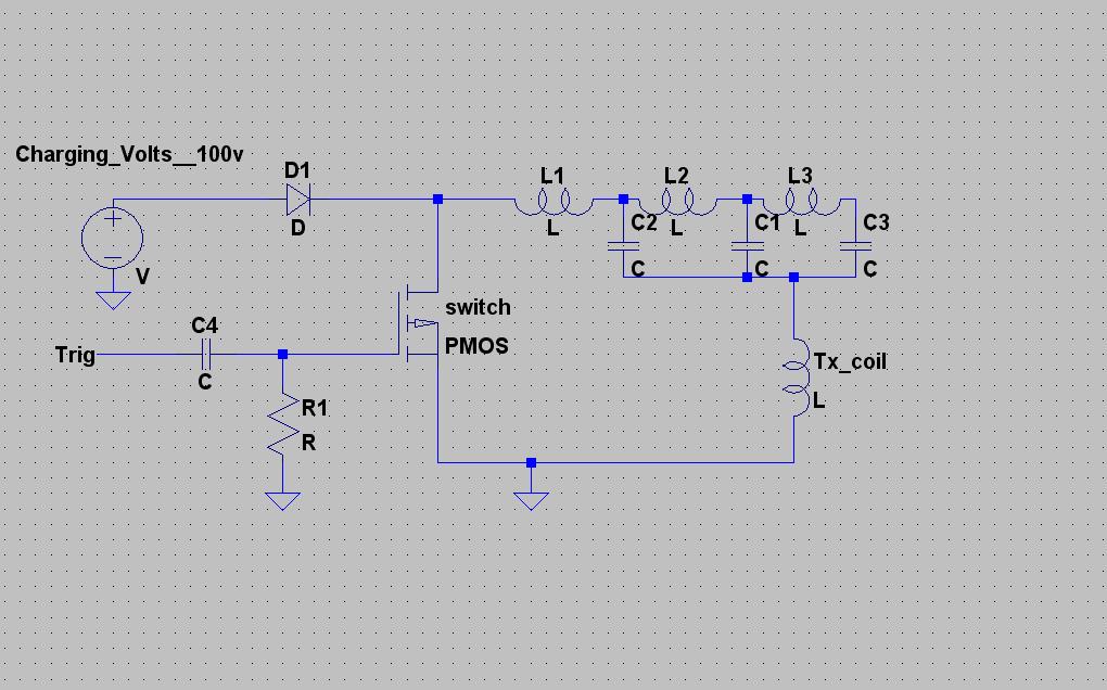

                  /years ago in a marine radio college I was taught how you get 25kW of RF energy into the sky in 1us.
                  Id guess there are legs in the following approach for getting more of a thum into and hence out of your coil.

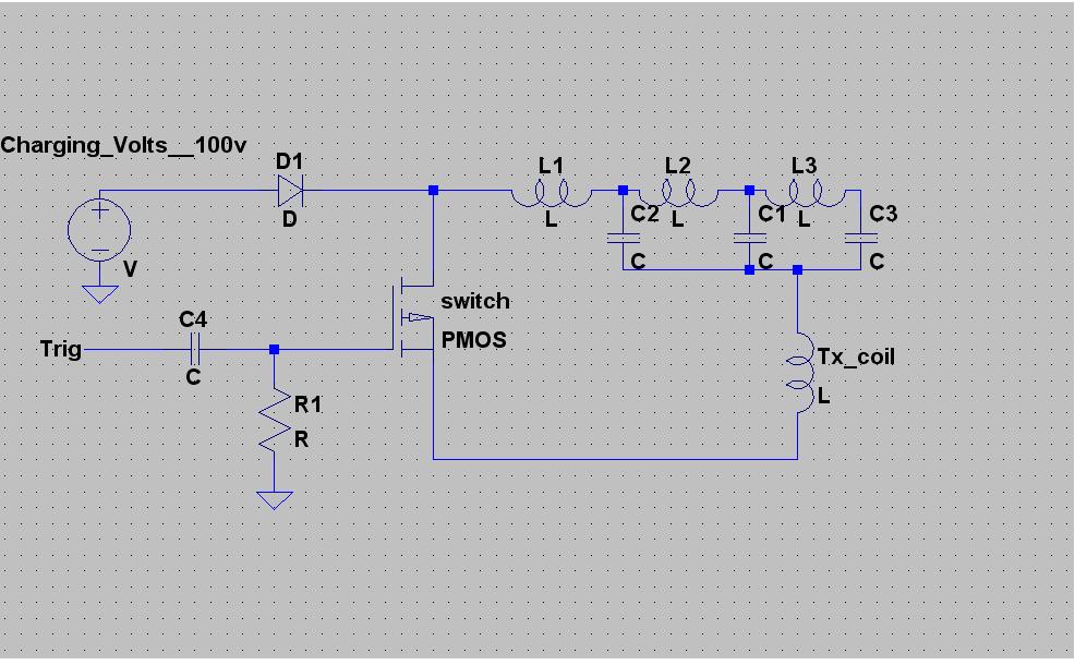

                  schematic wrong see next post
                    edwqed
                      edwqed
                      Golfnut, the schematic remains wrong because transistor shortens via diode the power source and inductance of PFN appears in series to TX coil. Please search the WEB for PFN or "Pulse Forming Network".
                      http://esr.lib.ttu.edu/bitstream/han...pdf?sequence=1
                        I agree with Mike, the body-diode integral to the FET will be forward-biased during charging.Is the FET meant to be enhancement n-channel?
                          poss work if there was an inductor after D1 and before drain of PMOS ,
                            This is only a teaser, not a functional final schematic.
                            It is a primary pulse forming network from a radar.
                            There are many ways of doing it.
                            essentially its charging up a delay line with stored charge - if all of the cct matches well U can discharge this stored energy in short time.
                            Much better than just turning a fet off.

                              The attached here circuit diagrams explain the main principle of TX with PFN. For rectangle pulses, the artificial line consists of three coils L1 - L3 and three
                              capacitances C1 - C3) .
                              The charging choke Lch, diode D1 and electronic switch S1 (thyristor) operate as a step-up converter charging the artificial line to enough high voltage. A resistor R1 is added for damping. C represents the equivalent stray capacitance.
                              However no need of rectangle pulses for PI, ie we can use a simple
                              PFN having only L1 (TX coil) and C1 (energy capacitor). No need of L2, L3, C2 and C3.
                              http://australianelectronicgoldprosp...p?topic=1076.0
                              Note that the TX of a classic PI detector is specific case (primitive simplification) of circuit diagram with PFN. In this case we can not use thyratron or SCR
                              (thyristor) for S1 because there is no inductances for self-quenching of thyratron.
