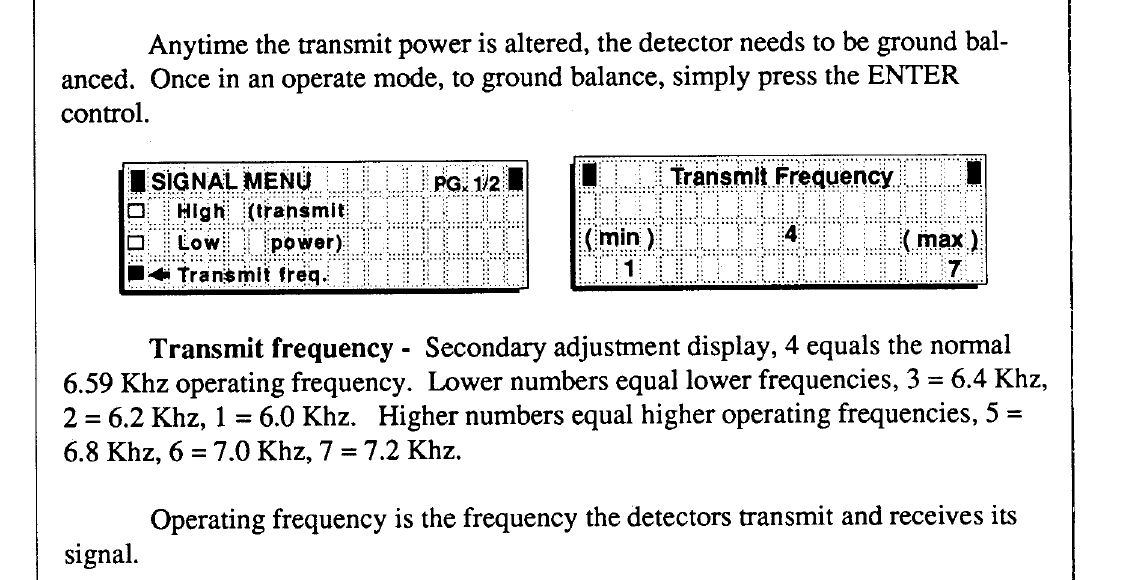

      The unit is actually 6.59 khz.

        Not according to the User Manual.
        http://media.whiteselectronics.com/m...n%20manual.pdf
          Homefire,The manual suggest 4= 6.59khz
          All the presets are set to 4.
