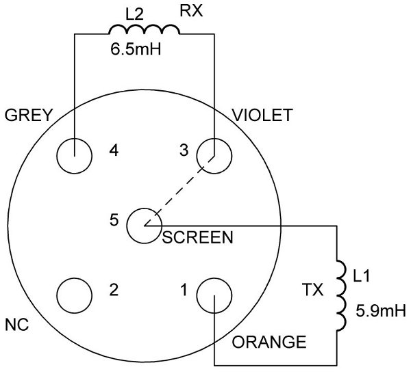

      And took above advise, I purchased a Tesoro Deepscan, 5 pin coil,... (EBay...)
      Just need to wire it in,........ Now, I have hunted, and hunted, {Cos I know Carl has posted a diagram of the standard 5 pin wiring,...}, but I cant find it,........ can anyone link me to the pinouts of the standard, 5 pin, Teroso coil?????
      Cheers, Fred

        Here it is:
          Thats the one!! Thank you so much,
          Cheers, Fred

              Now, the coil............... I was struggling to make it work,... I eventually stripped the plug off, and had a good run round with the multimeter. Turns out, not to be wired up, like the diagram above. This is what I found......
              I can only get it to run if I use the 6.2mH winding for the Tx, and the 5.7mH as the Rx, with the screen earthed, obviously the Rx coil is centre tapped to Earth.
              This causes the system to run at 16.2 Khz, but it does work, all be it at low sensitivity/range.
              So, Question, is it possible to strip the coil covers off, and shift the shield to where I need it, or am I stuffed??? HELP!!!

                  I would take a serious look at the TGSL board first.
                  Something does not sound right. I could not see anything wrong with the diagram until I look at the inductance values. I think the center tapped coil should be the receive side but the tx freq is way off for a 6.2 mh coil. It would go even higher with the 5.7 mh coil.
                  Before taking anything more apart on a good coil, I suggest checking you work on the TGSL board. In particular component value checking on your tx osc.
                  I would look at the coil as being correct and suspect the home made part until proven otherwise.
                  Good Luck with it.
                  Jerry

                    I would try this experiment:
                    Connect the green wire to TX J1-pin2 (ground).
                    Connect white wire to TX J1-pin1.
                    Connect red wire to RX J2-pin1 (non-inverting input)
                    Connect black wire to RX J2-pin2 (inverting input)
                    Optional: Connect screen through a 100K resistor to ground. Or don't connect at all.
                    See what you get.
                    If the target gives a double beep, reverse the white and green wires.
                    -SB
